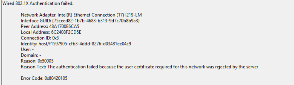

Sometime we facing issue the client suddently disconnect from the network and i got below error.
Is the client send different certificate to the nac? This is not permanent issue because if i re-plug the cable then the client can connect again

    No, this does not necessarily mean the client is sending a different certificate. Error 0x80420105 indicates that the certificate presented during 802.1X authentication was rejected by the NAC/RADIUS server.
    Since re-plugging the cable restores connectivity, this is more likely an intermittent reauthentication or certificate-selection issue than a permanently invalid certificate. Check the NAC/RADIUS logs at the failure timestamp and compare the certificate thumbprint/serial number with the successful authentication after re-plugging. Also check Event Viewer > Microsoft > Windows > Wired-AutoConfig > Operational on the client; if the same certificate fails first and succeeds after re-plugging, focus on the 802.1X reauthentication/session handling rather than certificate replacement.

    Yes. The error indicates that certificate-based 802.1X authentication was attempted, and the certificate presented for user authentication was rejected by the server.
    From the message shown:
    • Reason Text: "The authentication failed because the user certificate required for this network was rejected by the server"
    • Identity: host/...
    That points to a certificate validation problem during EAP authentication, not a random disconnect by itself. Common certificate-related causes in this scenario include:
    • expired certificate
    • invalid certificate
    • certificate chain verification failure
    • certificate revocation check failure
    • wrong or missing extended key usage (EKU)
    • multiple matching certificates on the device, causing the wrong certificate to be selected
