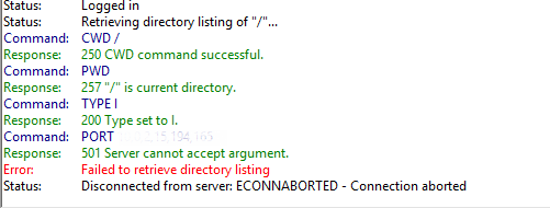

I got the issue like
200 Type set to I.Command: PORT 10,0,2,15,195,12 Response: 501 Server cannot accept argument.Error: Failed to retrieve directory listing
on FTP Any advice? Must I use passive for FTP?

    Your new log still shows a PORT command, which means FileZilla is still connecting in Active mode, so the server keeps rejecting it with the same 501. In passive mode you would see PASV or EPSV there instead. In FileZilla, go to Edit > Settings > Connection > FTP and set Transfer Mode to Passive. If you connect through Site Manager, also open the Transfer Settings tab for that site and set it to Passive, since a site-level setting overrides the global one. Then reconnect.
    You should now see 227 Entering Passive Mode followed by the directory listing. If it times out at that point instead, the problem has moved to the server side. On IIS, open FTP Firewall Support, define a data channel port range such as 50000-50100, and enter the public IP under External IP Address of Firewall if the server is behind NAT. Allow that range in the firewall, then restart the service with net stop ftpsvc and net start ftpsvc.

    Based on the error shown, I would recommend trying Passive Mode first. The FTP client is sending a PORT command that contains the private address 10.0.2.15, and the server is rejecting it with "501 Server cannot accept argument". This typically happens when the client is behind NAT and the server cannot establish the return data connection required by Active Mode.
    If Passive Mode works, the issue is likely related to the network translation between the client and the FTP server. If you must use Active Mode, verify that the client has a directly reachable address or consider using a bridged network configuration instead of NAT.
    If the FTP server is IIS FTP, also confirm that the passive port range and any firewall rules are configured correctly. If this helps, please accept the answer.

    The log shows the client is sending a PORT command, which means it is using active FTP. In active mode, the server must connect back to the client on the IP and port provided in that command. That commonly fails behind NAT or firewalls, and active mode is no longer recommended for Internet scenarios.
    What the error indicates:
    • PORT 10,0,2,15,195,12 contains a private client IP address (10.0.2.15).
    • A server on the Internet generally cannot connect back to that private address.
    • In IIS FTP, 501 means syntax error in parameters or arguments.
    • A failed directory listing is consistent with a data connection problem, not a login problem.
