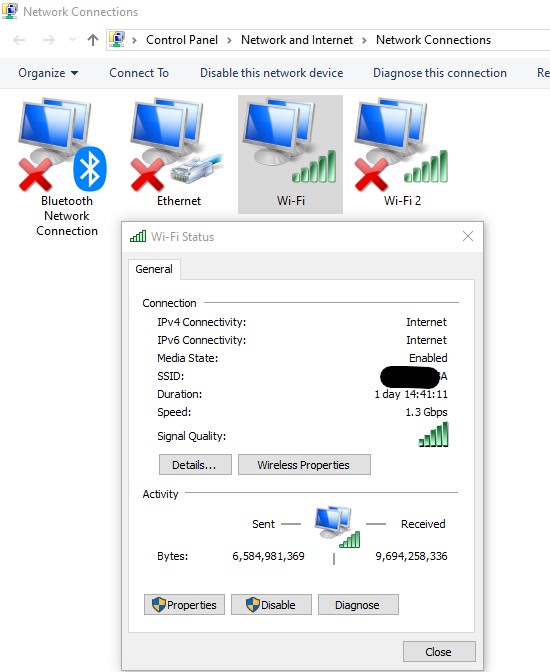

    I use the Control Panel to select how I want to connect to the internet. If you open the Control Panel, see if you have both a Ethernet connection and wi-fi. If you do and you have an Internet Service Provider, then select the one you want to use.
    I use the Control Panel and select which one I want to use. See the example image below. What have you selected? Do you have a wi-fi adapter? Who is your Internet Service Provider?
    ExapWiFiadapterStatus19
