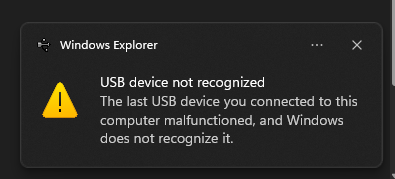

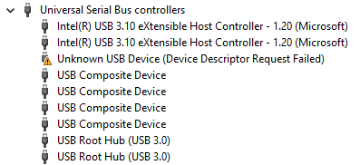

It shows "Unrecognized USB Device" when I connect my headset (USB-C type). It used to work before, like 2 weeks ago but now it's showing unrecognized. When I connect it, a new driver appears under Universal Serial Bus controllers, named "Unknown USB Device (Device Descriptor Request Failed)" I tried uninstalling that driver and restart the device to reinstall it. Didn't work. I have no idea what to do. Please help me.

    You can try resetting the USB controller to see if that resolves the issue. To do this, go to Device Manager > USB controllers, uninstall the "Intel USB 3.10 Extensible Host," and restart your PC immediately.
    Perform this step with the headphones disconnected; once you uninstall the driver, all USB ports will stop working. Upon restarting, the system will reload the USB driver and reset the controller. Test the headphones again after the restart.

    2. Check the Device Manager error details.
      • Open Start and search for Device Manager.
      • Find the device with the yellow warning icon under Universal Serial Bus controllers.
      • Right-click it > Properties.
      • Note the code shown under Device status and follow the troubleshooting for that code in Error codes in Device Manager in Windows.
