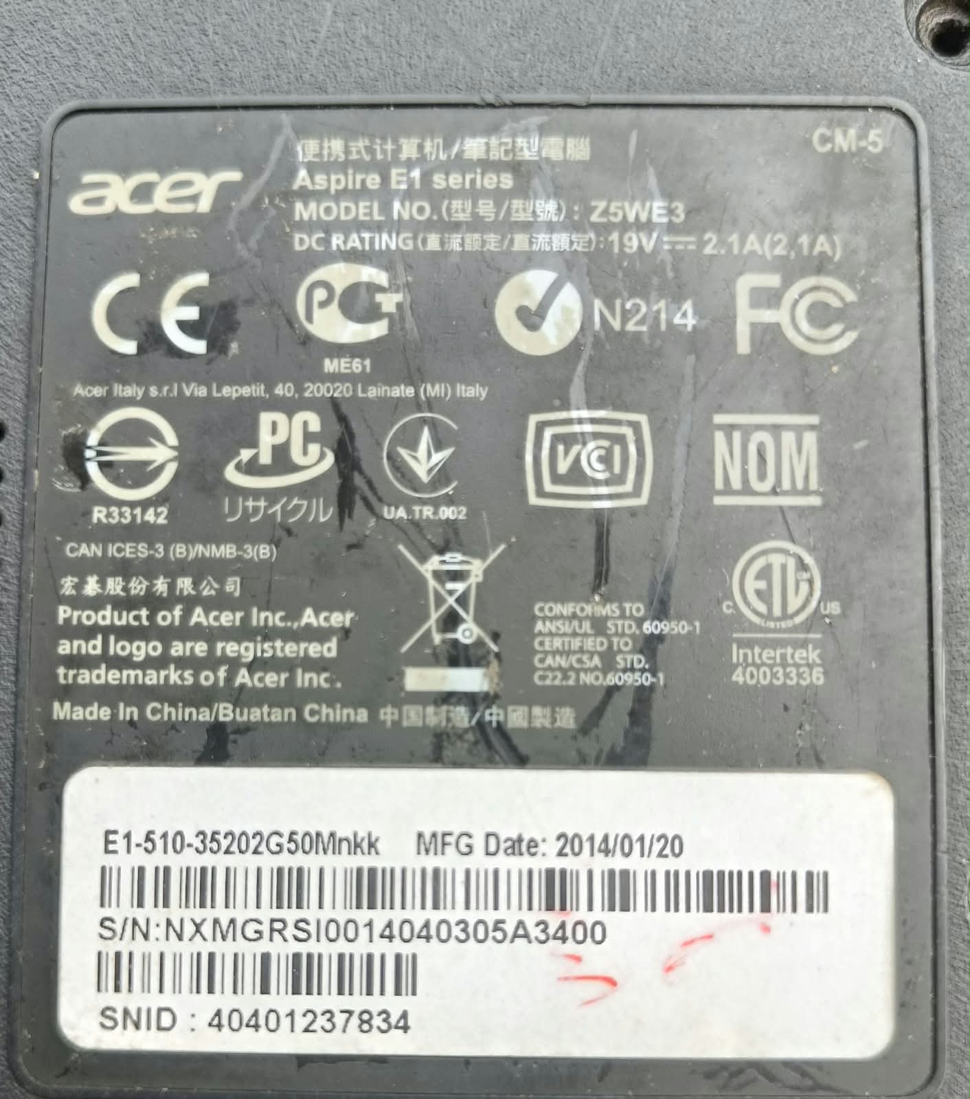

At first, my laptop was not turning on even when I connected the charger. Then I removed the battery from the laptop, and the laptop turned on. After that, I put the battery back in, and it is showing only 4% charge. The battery is not charging beyond 4%, even though the battery is new.

Hover over the battery icon in the taskbar and tell me what it says: "plugged in, charging", "plugged in, not charging", or something else. And what's the laptop make and model? That tells me whether the charger is the next thing to look at.

    Your description of the problem indicates most likely there is a problem with the battery, did you purchase that new battery direct from the laptop manufacturer or is it not an OEM battery purchased from a 3rd party retailer?
    Also, what is the make and exact model number of your laptop.
