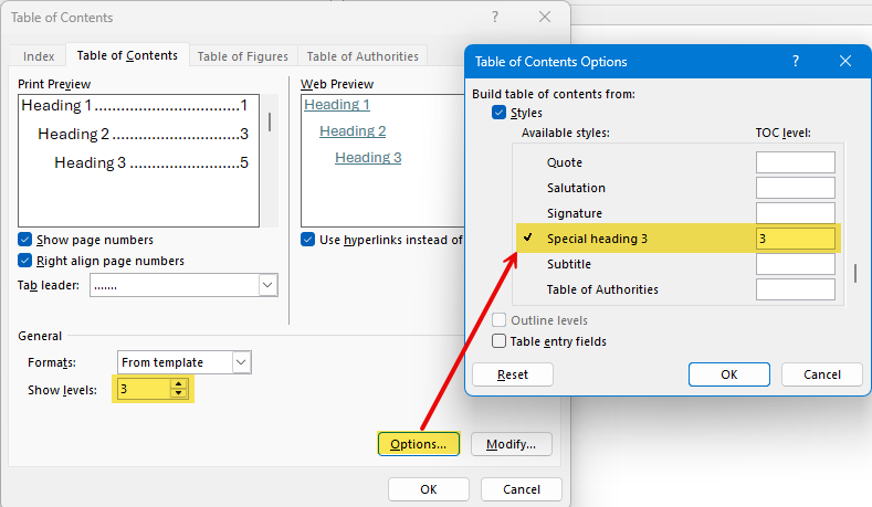

    To get this kind of code in a custom TOC, click References > Table of Contents > Custom Table of Contents. In the dialog, click the Options button. In the next dialog, scroll down the list of available styles to find the style you're using for your special headings. In the "TOC level" box to the right of that style, enter the TOC level where you want these headings to appear [this doesn't have to be the same as the style's Outline Level in the Modify Style dialog].
    3

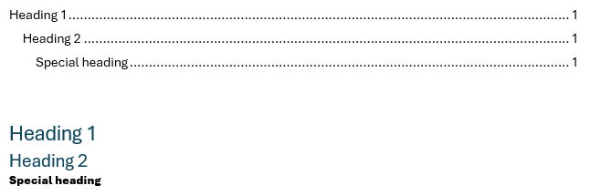

    The result of the field code shown above is this:
    5
