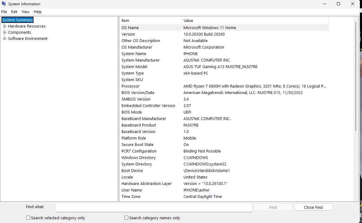

Hi ,
Search for msinfo32.exe in the search bar, take a screenshot, and post it here so we can see the correct laptop model or desktop configuration.
Thanks

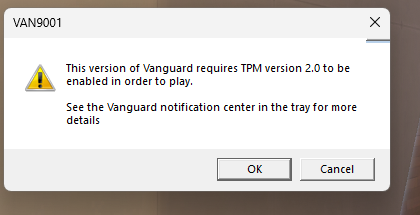

I cannot play valorant anymore after new update keep getting this error.
when I tried to enable it in bios this setting just does not exist anymore. I tried to turn of fast boot and then restarted to see if it would appear then and still has not appeared. And checking tpm.msc on windows says its not found so I dont know what changed in this update but why would you hide this option.

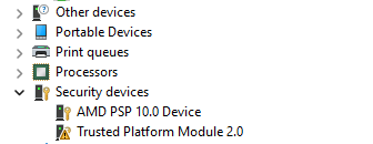

fTPM shows Code 10 and the PSP device is detected, and the fTPM option is missing in BIOS after an update.

Take a screenshot of Device Manager and post it here.
Thanks.

FA507RE, BIOS 312 and 315 both flashed via EZ Flash, defaults loaded, EC reset done. Device Manager: Trusted Platform Module 2.0 shows Code 10, Problem 0xA, Problem Status 0xC0000186 (device protocol error). No upper/lower filter drivers. AMD PSP 10.0 Device is present and healthy. Get-Tpm: TpmPresent False. The fTPM is not responding, which points to corrupted fTPM/PSP data or a motherboard fault. Please escalate to level 2 and advise on repair.

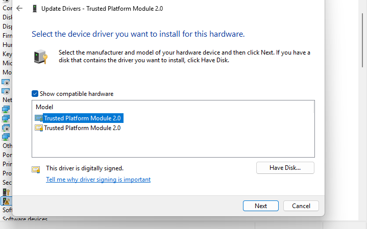

In this case, do the following: go to Device Manager > Trusted Platform Module 2.0 > Update driver > Browse my computer for drivers > Let me pick from a list of available drivers on my computer.
Take a screenshot and post it here.
Thanks.
Hi,
First, try testing both drivers to see if the system asks for a restart or if the driver starts without errors. If neither starts successfully, you can try running Valorant with VBS disabled:

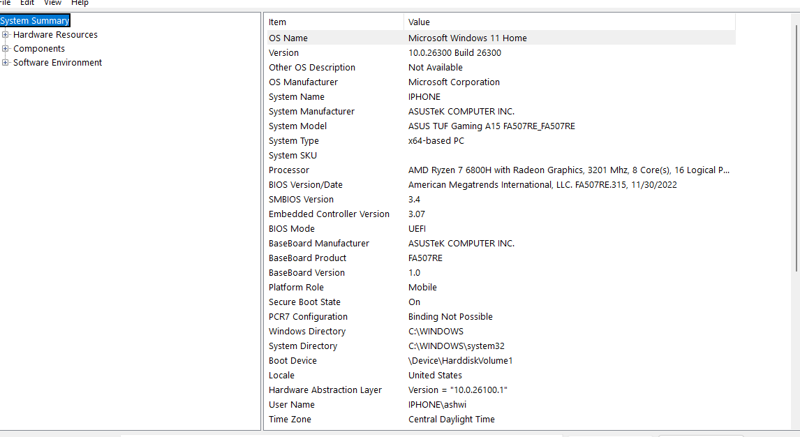

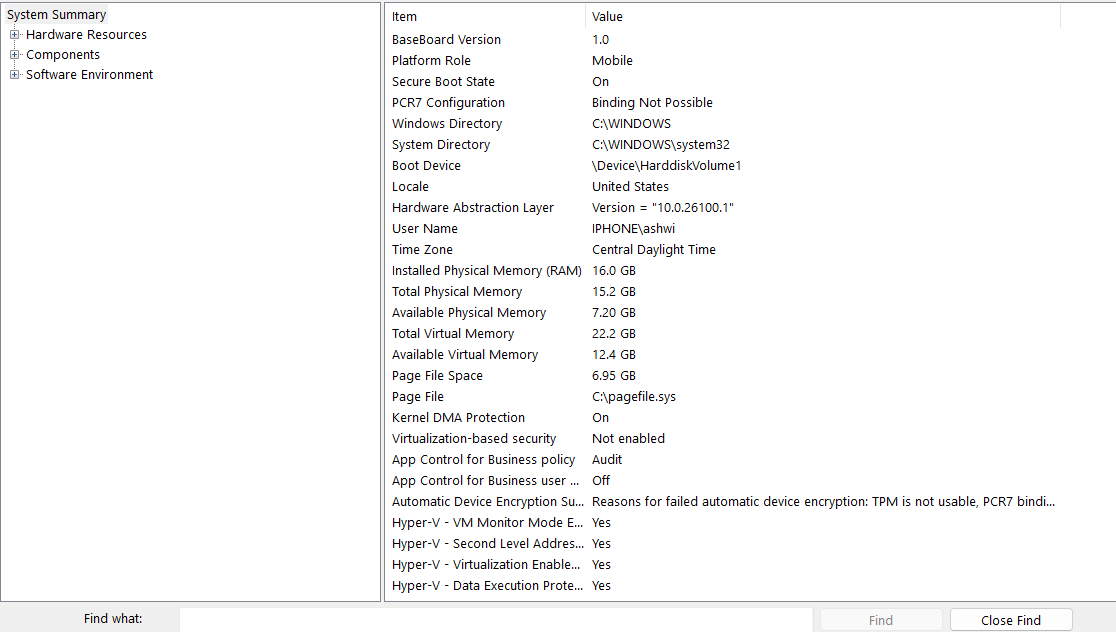

Restart your PC, then open Msinfo32.exe, take a screenshot, and post it here.
Thanks.
I tried testing both but then it just says this device cannot start and code 10. I will try disabling vbs now.
Memory integrity was already turned off, but i just run the command restarted and here is the msinfo
Hi,
If possible, scroll down further in msinfo32.exe, take a screenshot, and post it here.
Thanks.
Hii,

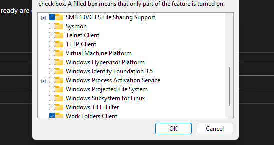

Press the Windows key, type Turn Windows features on or off, and press Enter
Uncheck the main Hyper-V box (this clears Hyper-V Platform and Management Tools).
Uncheck Virtual Machine Platform and Windows Hypervisor Platform if they are present.
Restart the PC and then take a screenshot of the bottom of msinfo32.exe again and post it here.
Thanks
All of those already are checked off

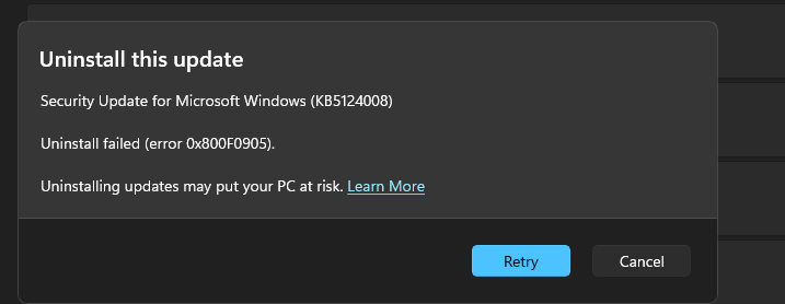

Since thats the case could you help me uninstall the last update I did
it just said error when i tried to delete it because this all started after that update took place

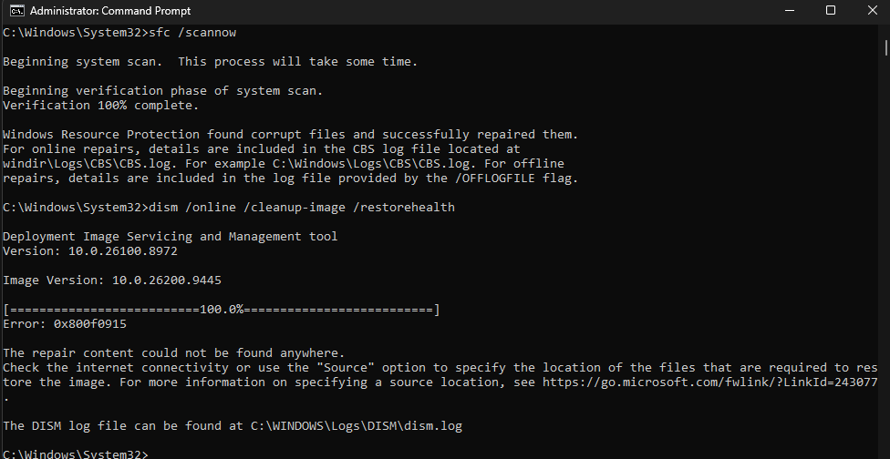

Hi,
Open the Command Prompt (as administrator) and run the following commands: sfc /scannow and dism /online /cleanup-image /restorehealth. Wait for the process to complete and restart your computer.
Then, open the Command Prompt again (as administrator) and run the command: wusa /uninstall /kb:5124008 to see if it uninstalls.
Thanks.
