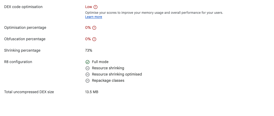

However, Google Play/Android optimization reporting currently does not show any percentage for Shrinking / Optimization / Obfuscation.
For comparison, the previous build without the above R8 configuration was showing 1% for Obfuscation.
I have verified that our build currently generates the ProGuard/R8 mapping file (proguard.map), but I do not currently see r8.json in the generated output/AAB.

As a result, Google Play currently displays - for the Obfuscation percentage rather than a percentage.
