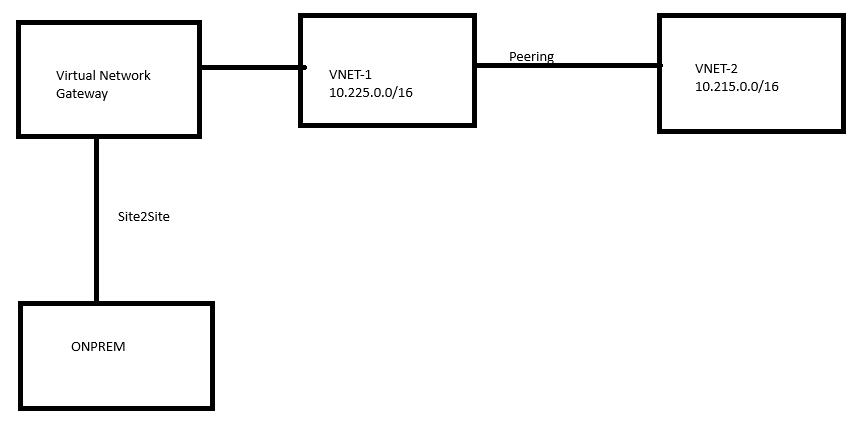

I have below topology and from my onprem i can't reach only to the private endpoint on VNET2 (VNET2 have private endpoint with IP 10.215.1.5 connected to Storage Account).
Then i do some simulation below :
  1. I put VM under same subnet on VNET2, the VM IP is 10.215.1.4 and from onprem can reach to this VM (i can RDP). Inside this VM i try access to https://10.215.1.5 and i the VM can access. This step eliminate routing issue from onprem to VNET2.
  2. I put another VM under VNET1 and i can access the VM from onprem and this VM also can access to Private Endpoint https://10.215.1.5.

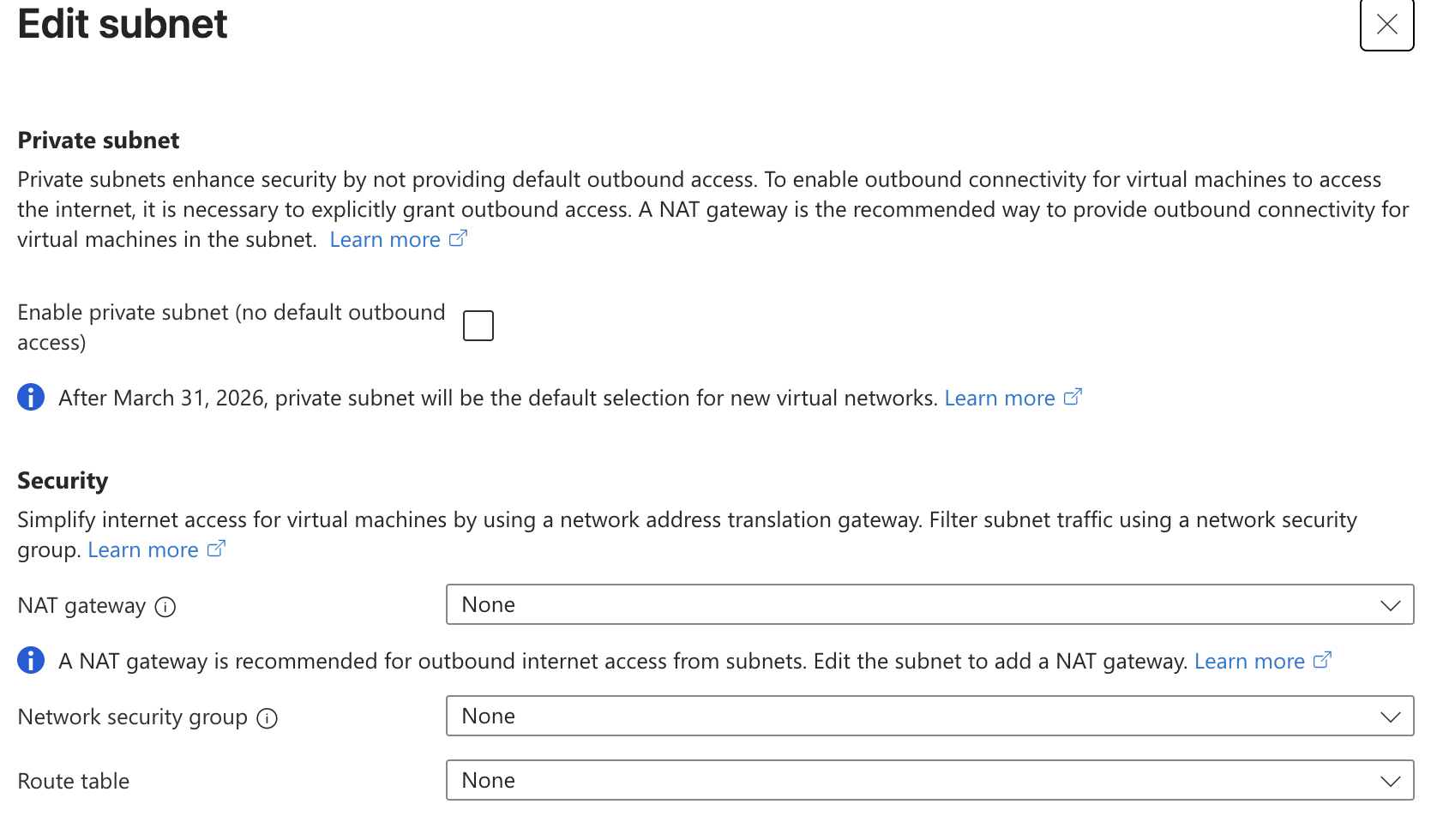

Anyone know why i can't access to PE 10.215.1.4 but can RDP to 10.215.1.4? There is no NSG on VNET-2
User's image

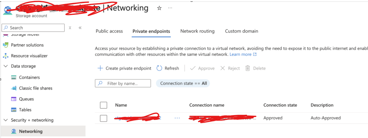

Here my Storage Account Network Configuration and Subnet Configuration
User's image
User's image

    Based on the testing you've already completed, I don't think this is a routing issue between on-premises and Azure.
    You have demonstrated that:
    • On-prem can reach a VM in VNET2 (RDP succeeds).
    • A VM in VNET2 can access the Storage Account through the Private Endpoint.
    • A VM in VNET1 can also access the Private Endpoint in VNET2.
    That confirms the Private Endpoint itself is functional and that connectivity between the VNets is working.
    The part that stands out is that you're testing access directly to the Private Endpoint IP (10.215.1.5). For Azure Storage Private Endpoints, Microsoft recommends accessing the Storage Account using its FQDN, not the private IP address directly. The Storage service relies on both the Private Endpoint IP and the Storage Account hostname for correct routing.
    I would verify the following from on-prem:
    • Run nslookup <storageaccount>.blob.core.windows.net and confirm it resolves to the Private Endpoint IP (10.215.1.5).
    • Access the Storage Account using the Storage Account FQDN instead of https://10.215.1.5.
    • Verify that your on-prem DNS servers can resolve the Azure Private DNS Zone records, either through conditional forwarding or DNS forwarding to Azure.
    If the Storage Account FQDN resolves correctly to the Private Endpoint IP from on-prem and access still fails, then I would start looking at firewall inspection or asymmetric routing on the on-prem side rather than Azure networking itself.

    Based on the tests:
    1. On-prem can RDP to a VM in VNET2
      • This shows on-prem to VNET2 connectivity exists for at least that VM path.
    2. A VM inside VNET2 can access the private endpoint
      • This shows the private endpoint and storage-side private link are working inside Azure.
    3. A VM in VNET1 can access the private endpoint in VNET2
      • This shows VNET peering between VNET1 and VNET2 is working for Azure-to-Azure traffic.
    That narrows the issue to the on-prem to VNET2 private endpoint path.

    1. Verify routing from on-prem to VNET2
      • When on-prem reaches VNET2 through VNET1, a static route from the on-prem side may be required so that both VNET1 and VNET2 prefixes point to the same VPN path.
      • Also verify there is no IP overlap between on-prem, VNET1, and VNET2.
