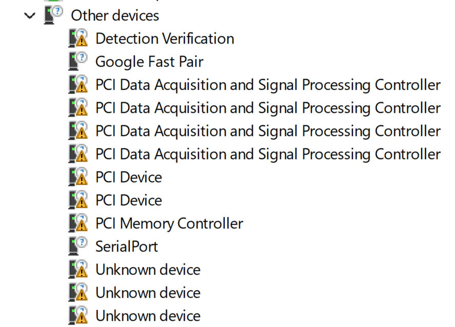

    2. Check Device Manager for hidden driver problems
      • Right-click Start > Device Manager.
      • Look for any device with an exclamation mark !.
      • For flagged devices, try Update driver.
      • If that does not help, try Disable device or Uninstall device.
