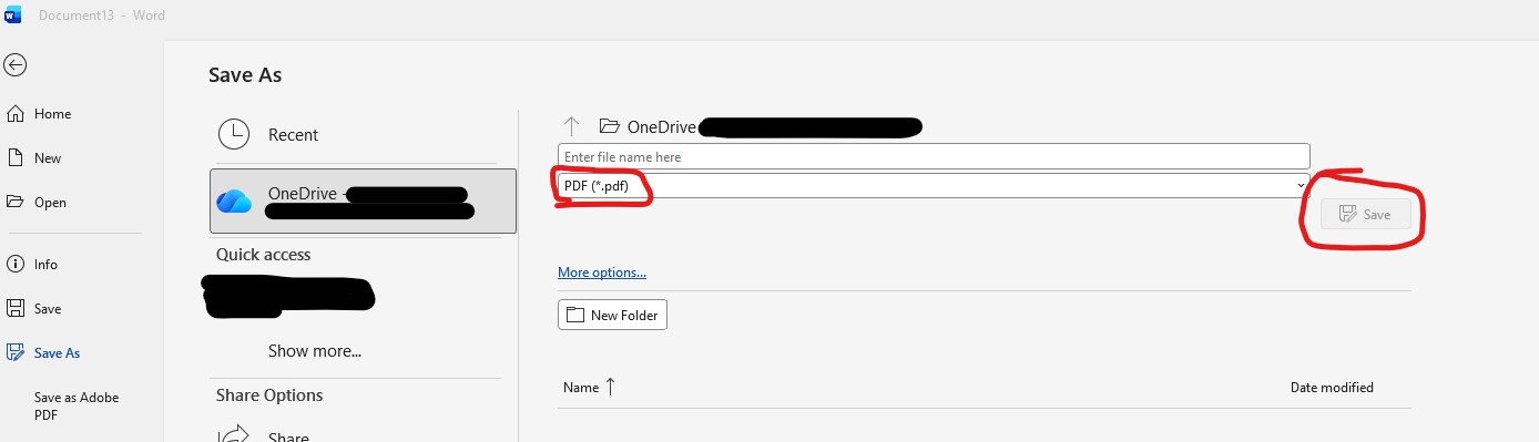

    I am also having this exact same issue across a handful of PCs in our network. It started with one PC earlier in the week, and now it's all of them. Workaround has been to print to PDF. Not ideal, but it works. I've attached a screenshot of the method the users are trying to save a WORD doc as a PDF. Doing a 'Save As', changing the dropdown to PDF. When they hit Save, Adobe (their default PDF viewer) opens the file, but when you browse to the location where you thought you saved the file, the file is not there. If anyone finds out more about this, please let me know. Screenshot 2026-09-25 084411
