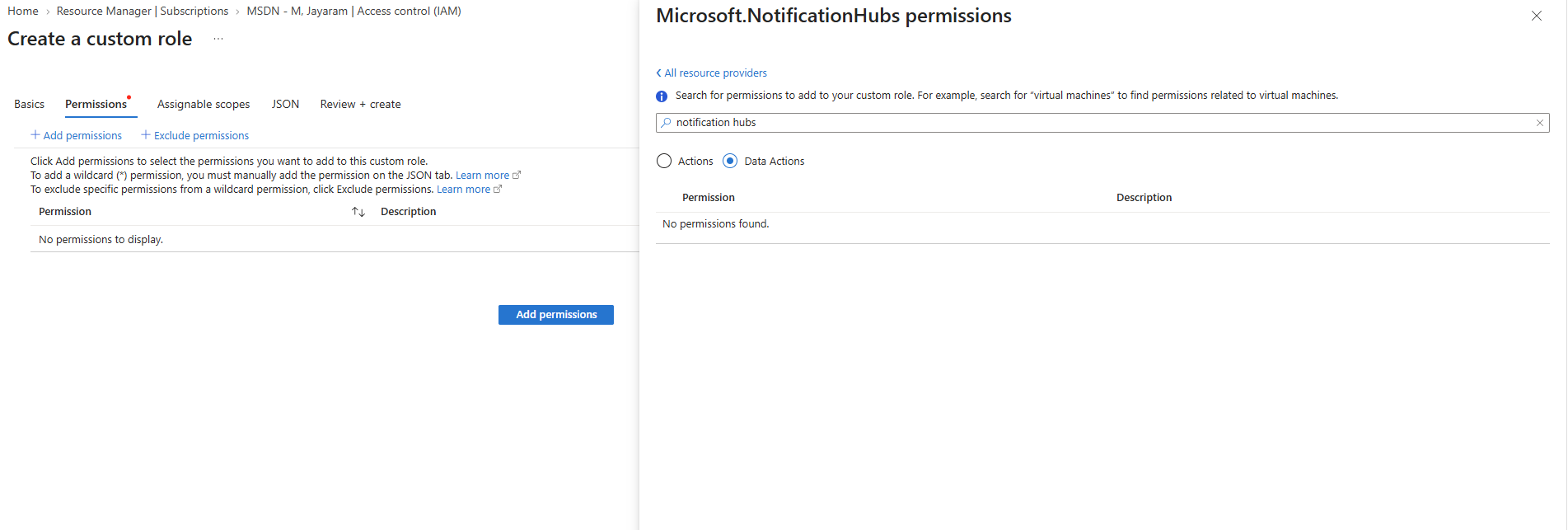

We have an Azure Function App using System-Assigned Managed Identity to authenticate to Azure Notification Hubs without connection strings. we are trying to implement Managed identity is it possible to achive?
What we investigated
  1. We checked Access Control (IAM) on the Notification Hub Namespace — there are no built-in roles for Notification Hubs listed (no Azure Notification Hubs Data Owner, Data Contributor, or Data Reader)
  2. When creating a custom role, the Data Actions tab for Microsoft.NotificationHubs shows "No permissions found" — there are no data plane RBAC actions enumerable for this service in our subscription
  3. The existing custom role assigned to the namespace (Notification Hub Operator) only has actions (management plane) with an empty dataActions array

  1. Santhi Siruvuri 10 Reputation points Microsoft External Staff Moderator
    2026-10-08T07:05:04.9333333+00:00
    Hello Jayaram,
    Thank you for sharing the detailed information and screenshots.
    Based on the current Azure Notification Hubs security model, the behavior you are seeing is expected. Notification Hubs uses Shared Access Signature (SAS) authentication with Listen, Send, and Manage claims for its operations.

    1. Which RBAC role should be assigned to the Managed Identity?
    There is no Notification Hubs data-plane RBAC role documented for authorizing these operations through Managed Identity. This is consistent with the "No permissions found" behavior you observed under Microsoft.NotificationHubs > Data Actions.
    Azure RBAC management-plane permissions should not be confused with data-plane authorization, as control-plane and data-plane operations have separate authorization models.

  2. Stanislav Zhelyazkov 29,826 Reputation points MVP Volunteer Moderator
    2026-09-24T11:38:25.4166667+00:00
    Hi,
    Azure Notarization Hubs does not support other authentication method besides SaS.
    So to answer your questions:
    1. Does Azure Notification Hubs support AAD Bearer token / Managed Identity authentication on the data plane (send notifications, manage installations)? - No
    2. What is the correct RBAC role or permission that must be assigned to a Managed Identity to allow it to call the Notification Hubs REST API with a Bearer token? - There is no such.
    3. Why do the built-in roles (Azure Notification Hubs Data Owner — GUID 17d1049b-9a84-46fb-8f53-869881c3d3ab) not appear in our subscription? Are they available in all regions/tenants? There is no such role. 17d1049b-9a84-46fb-8f53-869881c3d3ab is Storage Account Contributor role. Source.
    4. Is https://notificationhubs.azure.net/.default the correct token audience for Notification Hubs Bearer token auth? - No audience as Entra auth is not supported.
    5. If RBAC data plane is not supported for Notification Hubs, what is the recommended secure alternative to connection strings for a Managed Identity scenario? - Automate the regeneration of SaS and store the SaS on a key Vault as secret. Use user assigned identity to access the secret from the Key Vault. For automation you can use various services like Logic Apps, Functions, Azure Automation, etc.
