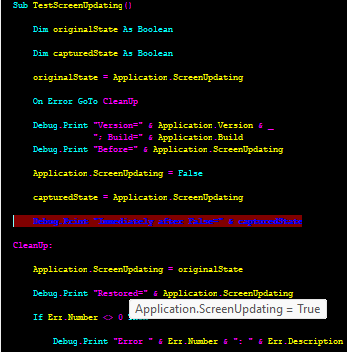

  1. KF4UYC 60 Reputation points
    2026-09-21T14:58:03.6866667+00:00
    Jay,
    Greetings, loaded up your code and if it taught me anything as a life-long developer is to never trust what you see but rather what your code tells you...!
    Your snippet proved to be correct in that the Boolean state is being changed (see your output below) and I should have tested in debug (duh!) instead of value-hovering over the variable name (see photo)...the hover value continues to say 'True' but in fact your code proved it to be otherwise. I went back to the original code and indeed debug tells me "False' but hover tells me 'True'...my bad! As for the screen behaviors I will need to look elsewhere to see if any of my staff changed something upstream.
    Thanks for all the help...it was greatly appreciated and humbling to say the least!
    James
