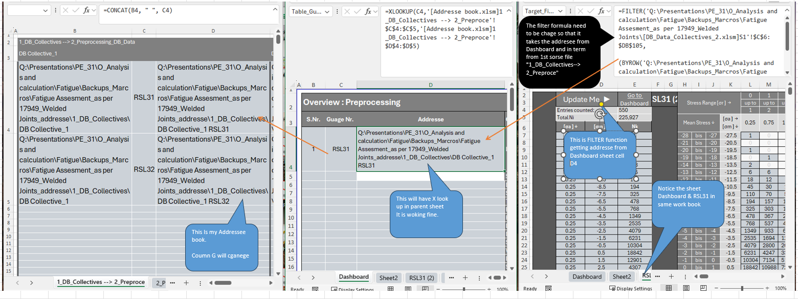

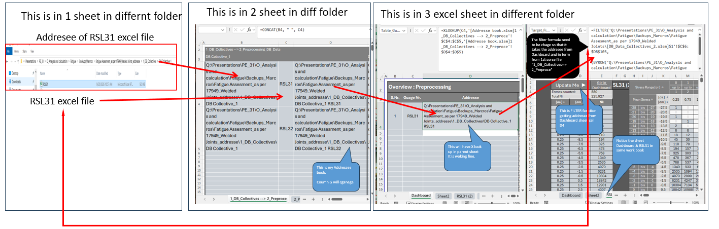

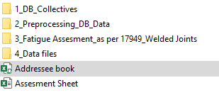

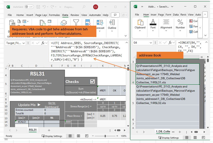

  1. Chaturvedi, Santosh 650 Reputation points
    2026-09-20T16:14:21.18+00:00
    Hello Please see belowPlease carefully see
    I have one RSL31 parent sheet in differnt folder
    Then addresee book in 2 sheet by CONCAT action
    The 3 excel sheet have filter formula that links with addrese book see fig
