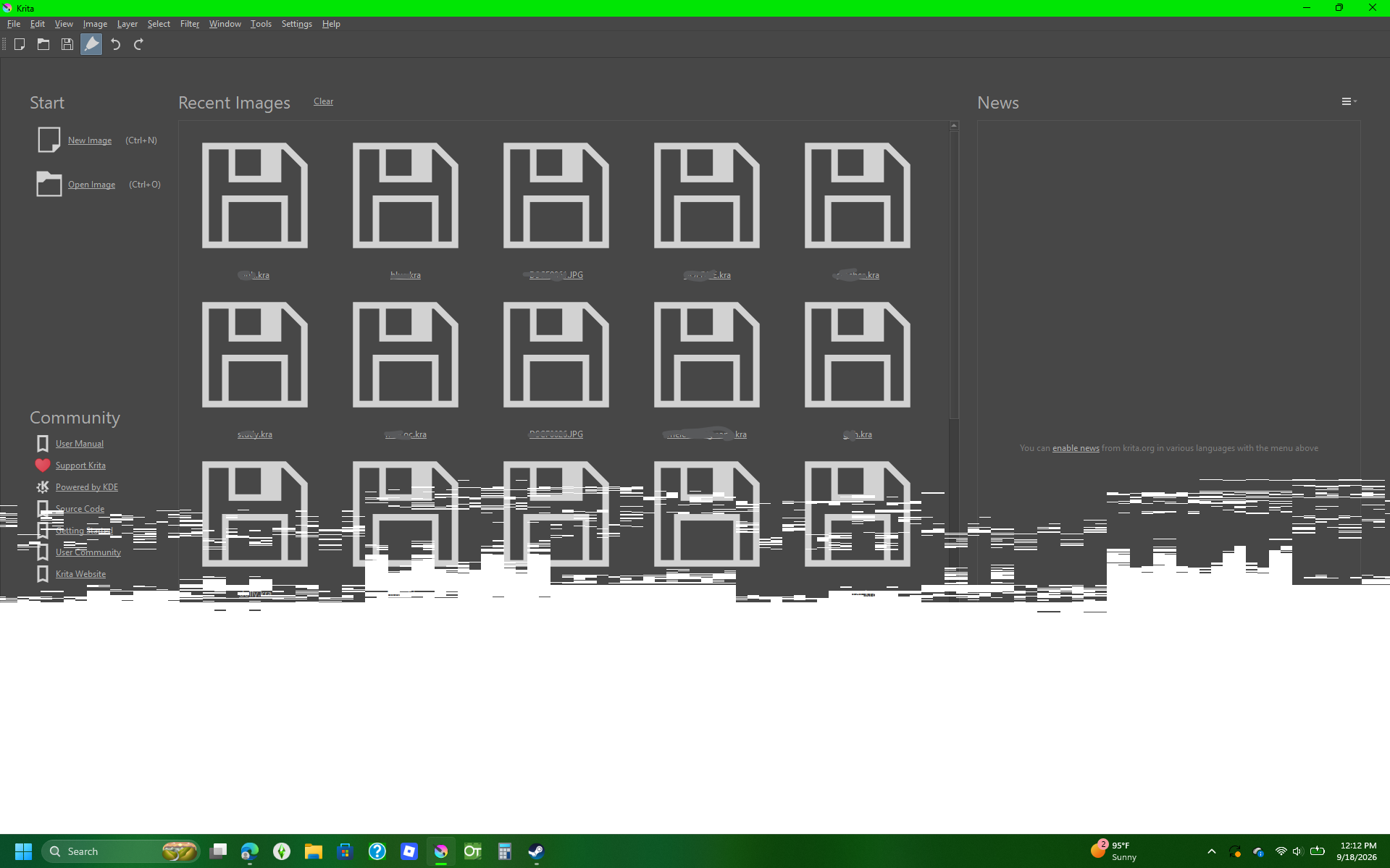

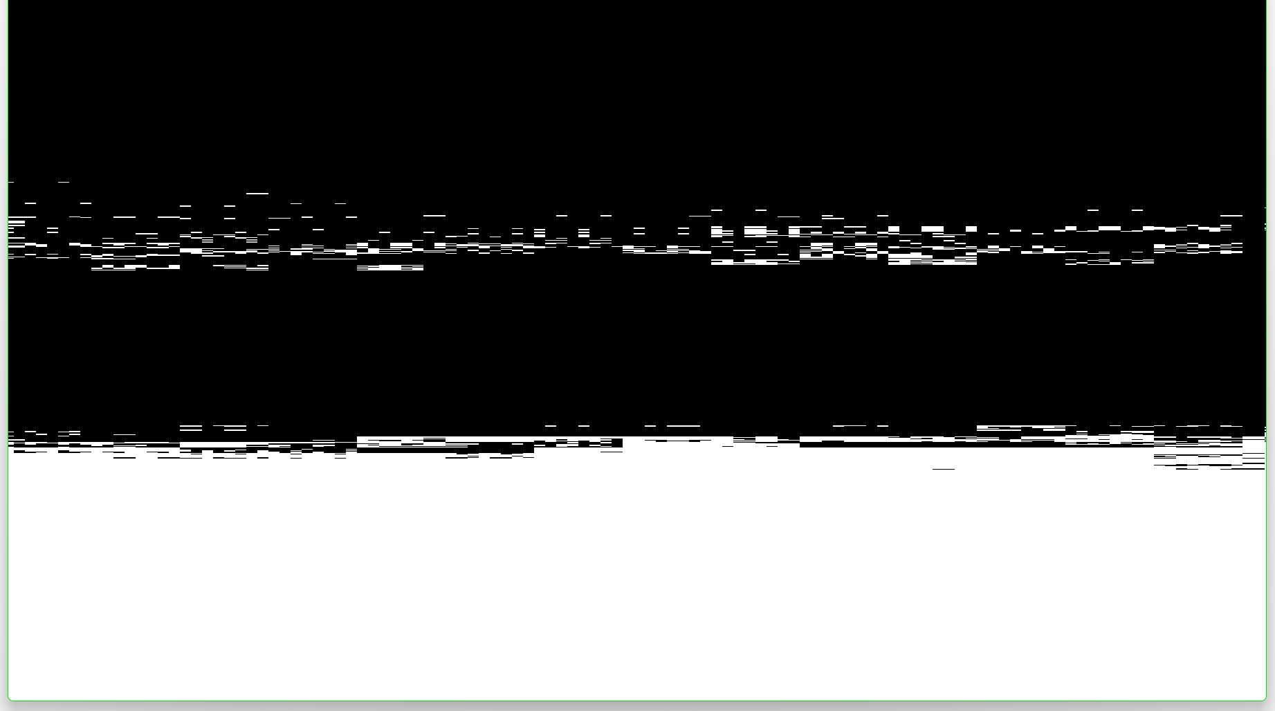

this is the second program to start opening this way, and it's not a one-time thing. ive given it days, ive restarted the programs, but it's acting like that's just what these prgorams look like now. for krita, i cant open any of the files it shows me, it just stays on that screen. for scarlet hollow, nothing is displayed so i assume i wouldnt be able to press anything. the game has a custom cursor that still shows, though, if that means anything? i dont know what the issue is so i don't know how to fix it !!!
programs were krita (picture one) and scarlet hollow (picture two) (game downloaded from steam)

    Thanks for sharing the screenshots. Since the same visual corruption is appearing in two unrelated programs, I’d like to narrow down whether the issue is coming from the graphics driver or another program running in the background.
    While the problem is visible, please press Ctrl + Shift + Esc to open Task Manager and let me know whether Task Manager also appears distorted. If it does, that points more toward the display driver. If Task Manager looks normal, an app or background-software conflict is more likely.
    Could you also confirm:
    • The graphics adapter listed under Device Manager > Display adapters
    • The Windows version and build shown after running winver
    • Whether this began after a Windows or graphics-driver update
    • Whether the corruption appears in any other programs or on another monitor, if available
    As a quick test, press Windows + Ctrl + Shift + B to reset the graphics driver. If the issue started after a recent driver update, open Device Manager > Display adapters, open the graphics adapter’s Properties, and select Driver > Roll Back Driver, then restart the computer.
    If Task Manager looks normal and the issue continues, the next useful step would be testing in a clean boot to rule out interference from another startup program.
    Let me know what you find and I’ll help you narrow down the next step.
