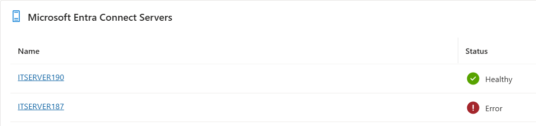

I recently updated one of two servers to the Entra Connect Sync version 2.6.84 from 2.4.21.0. I followed the steps to upgrade our staging server first, then change the staging to active and make the active server the new staging. I haven't upgraded the second server yet as we appear to have run into issues on the first server.
As you can see in the screenshot we have an active error on ITSERVER187.

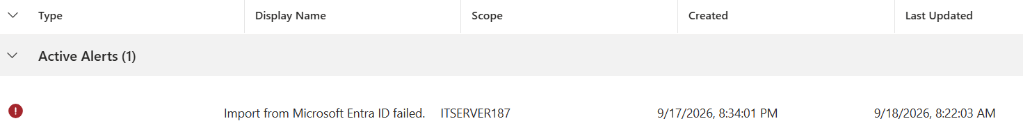

The active error is the following:
User's image

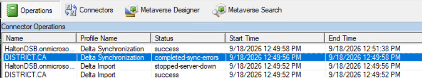

I have since swapped the Active and Staging again back to what it was thinking that may have been part the issue. The original active server is still running Entra Connect Sync 2.4.21. We haven't updated it, thinking maybe there is an issue with the update.
I see the sync is running on the staging server (ITSERVER187) but there are errors and these errors weren't here until after the update. The stopped-server-down appears to happen all the time on this staging server and it didn't just start happening after the update.
User's image
Just looking for some guidance on what to try here and has anyone experienced this while upgrading to this version?

    4. Since the error shown is “Import from Microsoft Entra ID failed” and the Sync Service Manager shows completed-sync-errors, clean up the synchronization step errors first. Microsoft documents that Events 6311 and 6401 are logged after a synchronization step error, and the fix is to resolve the underlying synchronization step errors.

    The stopped-server-down entry on a staging server is not enough by itself to prove the upgrade failed. The more important signal is the Microsoft Entra ID import failure and the sync step errors on the upgraded server. Focus troubleshooting there before another cutover.
