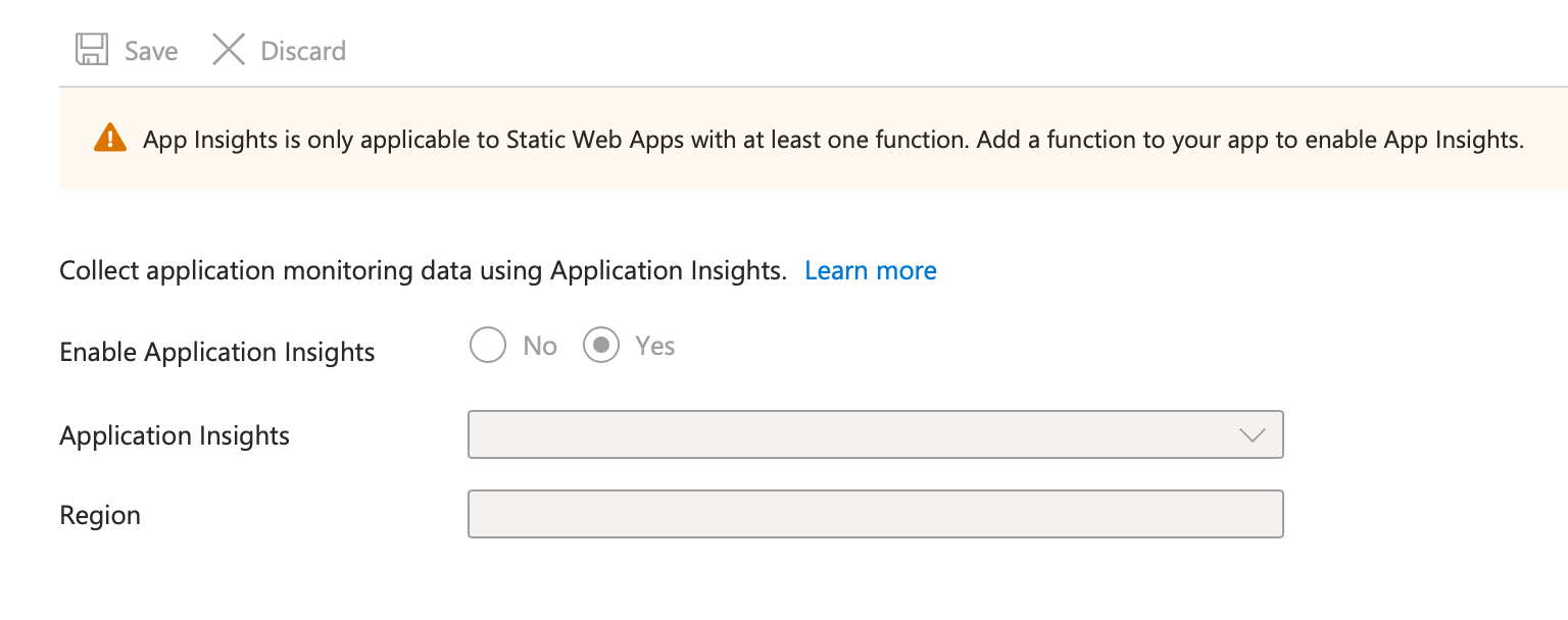

  2. Users report that the Application Insights blade shows "Add a function to your app to enable App Insights" when zero functions were detected. Treat that as an indicator, not a documented diagnostic contract. The same reports describe this combination, no functions listed while the Diagnose and solve problems blade still counts backend 5xx errors, as the typical signature of a function app that fails to index (Azure/static-web-apps issue #1731, and the Q&A thread StaticWebApp build/deploy job runs successfully but APIs/managed functions are not deployed correctly). Those are user observations, not documented behavior, but they match what you describe.
