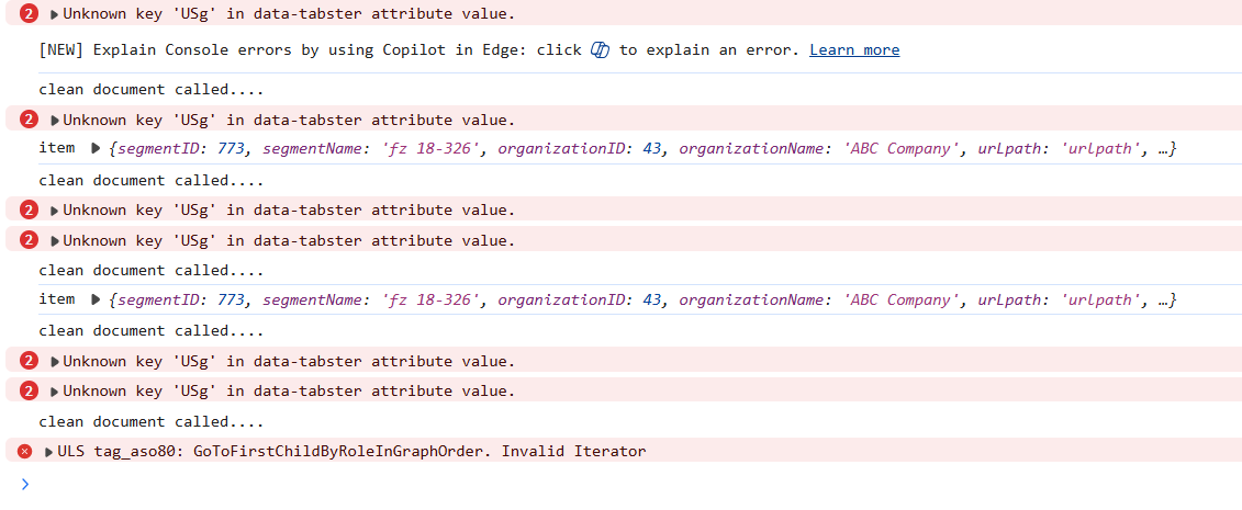

    5. Error details - please check the attached image file for errors. Errors screenshot.png
      • For the "OOXML malformed" error, please provide the complete error message and error code, if available.
      • If the operation fails silently, please confirm whether the returned Word.run()/Promise is resolving successfully or whether an exception is being caught elsewhere.
