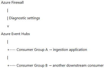

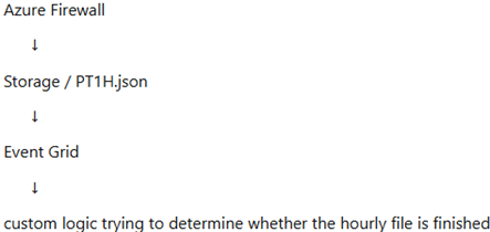

    Architecturally, use:
    User's image
    rather than:
    User's image
    Event Hubs removes the need to determine when an hourly blob is "complete." Your consumer can process the resource-log events as they're delivered and maintain its progress using the Event Hub consumer offset/checkpoint.
