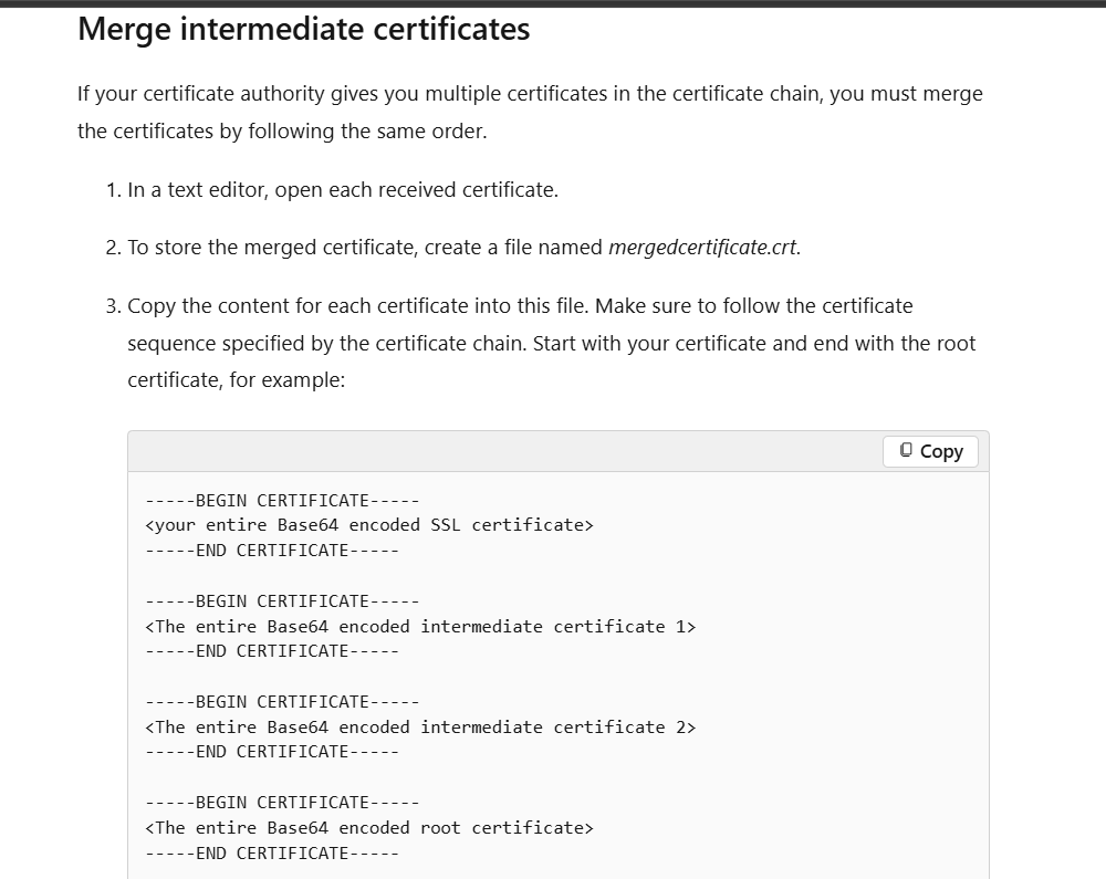

    This is a very common issue when working with GoDaddy certificates and Azure App Service. The "Certificate of Authority" error almost always means the .pfx file you uploaded is missing the intermediate certificate chain. GoDaddy issues the certificate in parts your domain certificate (.crt) plus one or more intermediate/bundle files (.pem) and Azure needs all of them merged together in the correct order inside a single .pfx.
    Here are clear step-by-step instructions to build the correct .pfx using OpenSSL (free and available for Windows, macOS, and Linux):
    Step 1: Identify your files from GoDaddy
    GoDaddy typically sends you:
    • yourdomain.crt — your actual domain certificate
    • gd_bundle.crt or one or more .pem files — the intermediate/chain certificates
    • You should also have your original private key file (.key) from when you generated the CSR
    Step 2: Merge the certificate and the bundle into one file
    Run this command to combine them in the correct order (leaf certificate first, then intermediates):
    cat yourdomain.crt gd_bundle.crt > mergedcertificate.crt
    On Windows (using Command Prompt), use:
    copy /b yourdomain.crt + gd_bundle.crt mergedcertificate.crt
    If GoDaddy gave you multiple .pem files instead of a single bundle, concatenate all of them in order after your domain cert:
    cat yourdomain.crt intermediate1.pem intermediate2.pem > mergedcertificate.crt
    Step 3: Create the .pfx file using OpenSSL
    openssl pkcs12 -export -out yourdomain.pfx -inkey yourprivate.key -in mergedcertificate.crt
    OpenSSL will prompt you to set an export password — make sure to remember it, as Azure will ask for it when you upload.
