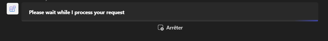

  • The answer is generic and not grounded in Azure AI Search results so it seems that when the agent doen't call the tool, it works.
  • When it needs to call the tool, the UI stays on “Please wait while I process your request”.
    User's image
2️⃣ Tool forced ("always use tool")
The agent stops responding in Teams.
The UI stays on “Please wait while I process your request”.

  1. Ismail Yazini 30 Reputation points
    2026-03-11T03:41:09.1666667+00:00
    Hi Anshika Varshney,
    Thank you for your time.
    I verified the published agent identity and assigned additional permissions to the published agent application identity for Azure AI Search to make sure. I also republished the agent and tested multiple times in Teams and Copilot.
    To isolate the issue, I tested the published Agent Application directly through the Responses API endpoint instead of only through Teams. Both of the prompts that were failing in Teams completed successfully through the API, including Azure AI Search tool usage. This confirmed that:
    • the published agent itself is working correctly
    • the model execution does start
    • Azure AI Search retrieval is working
    • the problem is not with the Search RBAC anymore
    After that, I found the actual cause. The issue was related to response formatting in Teams / Copilot. At some point, I got "Text not extracted" in the Copilot chat. So I updated the instructions to force simple plain-text responses only, with no markdown tables, no complex formatting, no citations markup, and no special characters, the agent started responding correctly in Teams.
    So in my case, the root cause was not ultimately tool permission or model execution, but a formatting/rendering issue in the Teams / Copilot channel path.
    What fixed it was simplifying the output format, for example:
    • plain text only
    • no markdown tables
    • no complex structured layouts
    At this point, the agent works in Teams as long as the response format is kept simple. I'm not sure which step is responsible for this limitation but whatever.
