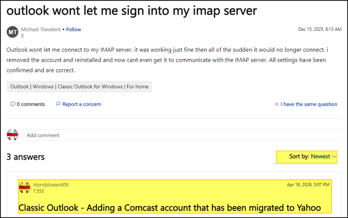

Michael Travalent 0 Reputation points
2025-12-15T14:13:12.5033333+00:00
Outlook wont let me connect to my IMAP server. it was working just fine then all of the sudden it would no longer connect. i removed the account and reinstalled and now cant even get it to communicate with the IMAP server. All settings have been confirmed and are correct.

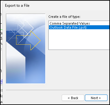

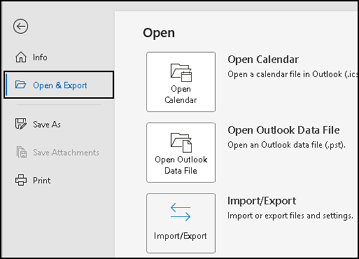

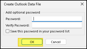

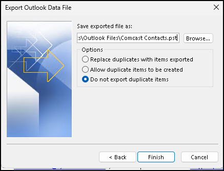

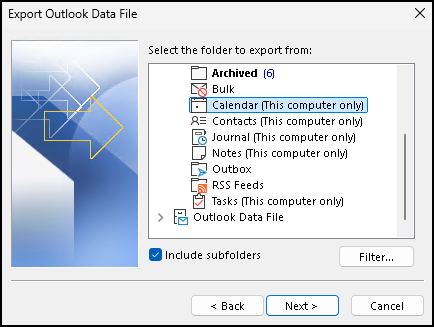

    If you have any "This Computer Only" folders under your existing Comcast account with data that you need to keep (e.g. Contacts, Calendar) you must export them to a PST file since they will be lost when you remove the Comcast account.
    For each "This Computer Only" folder do:

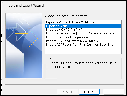

    • File -> Open & Export -> Import/Export
    • Export to a file, [Next]
    • Create a file of type: Outlook Data File (.pst), [Next]
    • Select a "This computer only" top level folder, [Next]
    • Browse to a folder on your computer where you want to save the PST file and name the file something you will recognize. (e.g. "Comcast Contacts", "Comcast Calendar"), [Finish]
    • Create Outlook Data File, {don't add any password}, [OK]

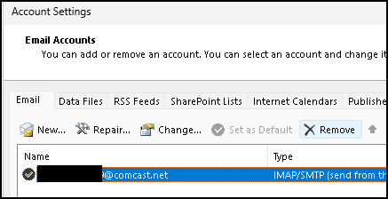

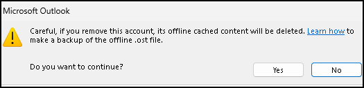

    2 -- Remove the old Comcast account from Outlook.
    • File -> Account Settings -> Account Settings
    • Select your Comcast Account and [Remove]
    • Do you want to continue? [Yes]

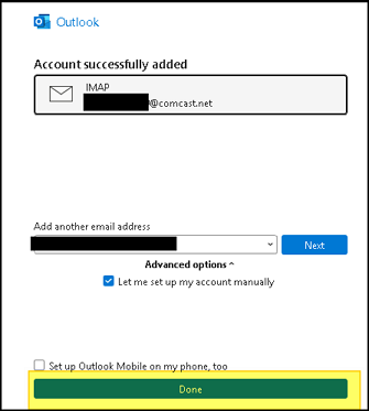

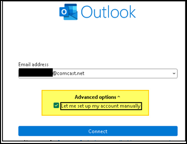

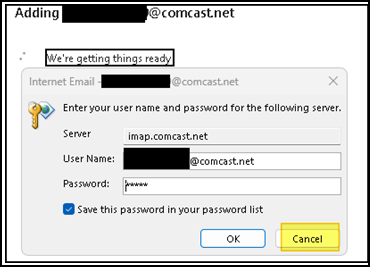

    3 -- Add your Comcast/Yahoo account
    • File -> Add Account
    • Enter your Comcast email address.

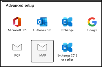

    • Click "Advanced Options", check "Let me set up my account manually", [Connect]
    • On the Advanced setup page choose IMAP.

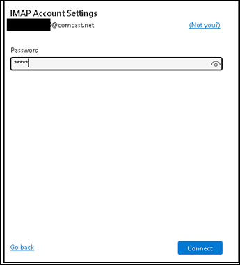

    • On the IMAP Account Settings page enter "XXXX" (not your real password), [Connect]

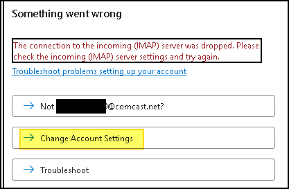

    • On the Adding .... dialog, [Cancel]
    • On the Something Went Wrong page [Change Account Settings]

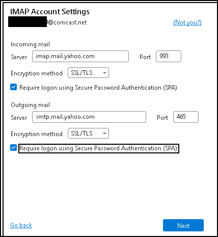

    • On the IMAP Account Settings page enter the values shown, [Next]
    • (Settings from https://help.yahoo.com/kb/SLN4075.html)

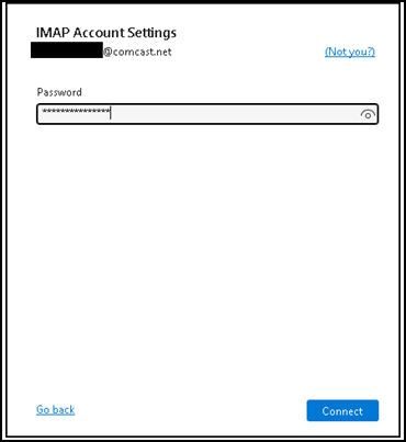

    • On the IMAP Account Settings page enter your real Comcast password

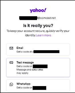

    • On the Yahoo Sign in page enter your Comcast email, [Next]
    • On the Is It Really You page pick a verification method and complete the authentication.

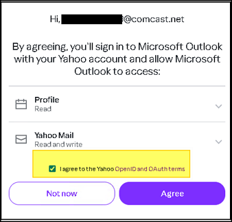

    • On the Agreement page check the "I agree to the Yahoo OpenID and OAuth terms, [Agree]
    • You made it!
