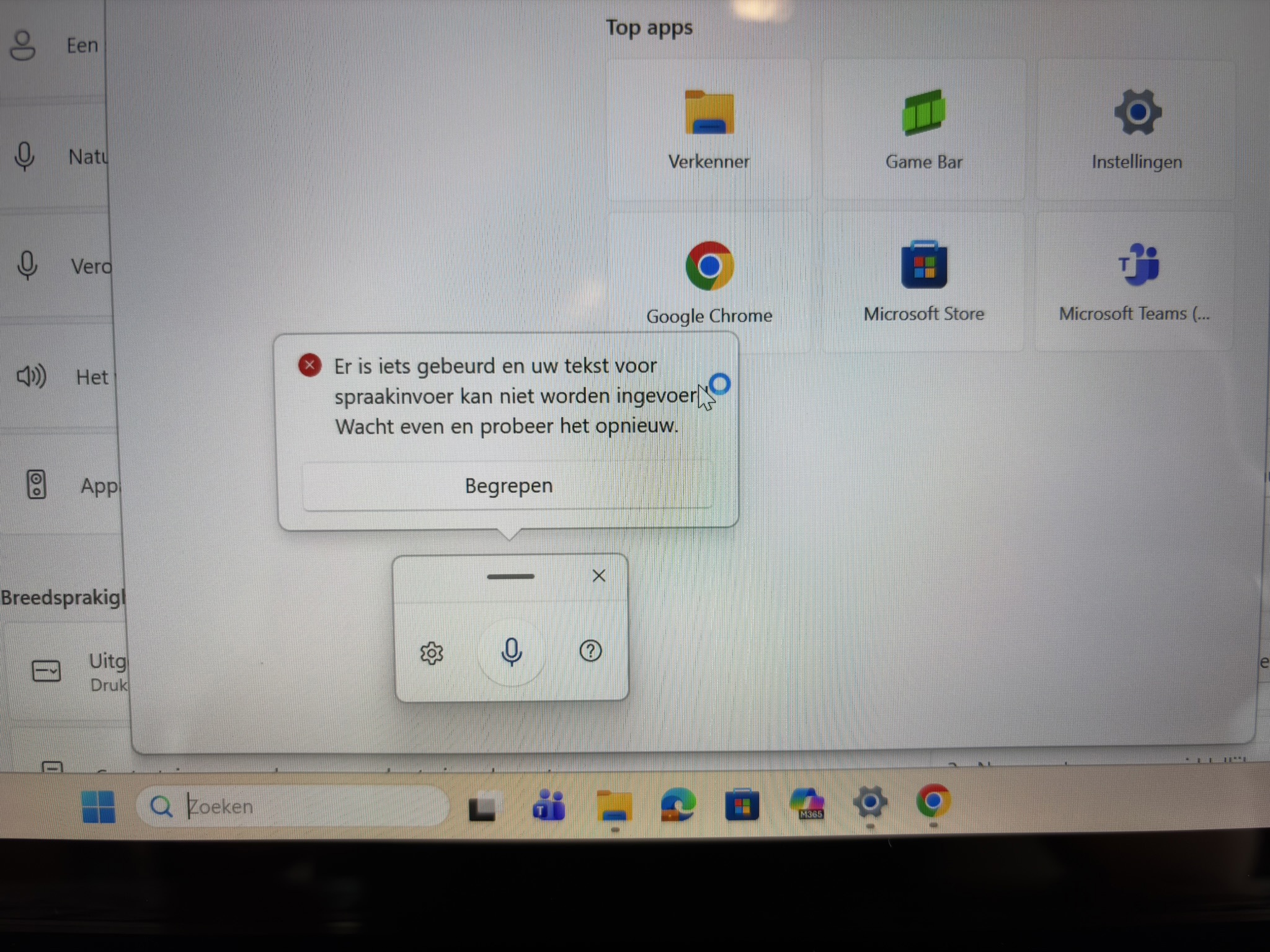

win+H worked daily for years, 2 days ago it stopped working. the command opens the voice interface but gives me the error: There was a connection issue, please try again. No error code. I have tried all these suggested fixes:

i tried all of that from a previous post another user had plus all this:
  1. system restore
  2. disabling extensions in edge
  3. disabling extensions in chrome
  4. running in safe mode
  5. create a new win 11 profile account
  6. refreshing all network settings
  7. using cellular data via hotspot
  8. pulling all my hair out
  9. cursing at my cat
  10. restarting the system multiple times
  11. tested with several other programs and apps (whisper, some extensions) they all dictate my speech just fine
mic works fine, all settings gone over with a fine tooth comb. uninstalled, reinstalled everything from realtek drivers to wifi adapters. this is incredibly frustrating.

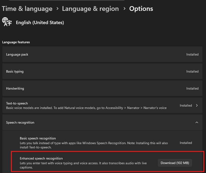

    Previously, Win + H voice typing relied mainly on Microsoft’s cloud-based speech services until a recent Windows update changed this behavior. The system now expects the Enhanced Speech Recognition component as part of the speech pipeline for better reliability and offline fallback. If it’s missing, you may see the “There was a connection issue” error, even if your microphone and internet connection are fine.
    Here's how you can address the issue, please kindly follow (I have provided an image as instruction below):
    • Go to Settings → Time & language → Language & region.
    • Under your language, click (•••) then choose Language options.
    • Download Enhanced speech recognition.
    • Restart your PC and try Win + H again.
    User's image
    This should restore voice typing functionality. I know it’s frustrating when updates change familiar behavior, but this adjustment is designed to make voice typing more consistent and resilient. Thank you for your patience and persistence, you’re very close to getting this working again!
