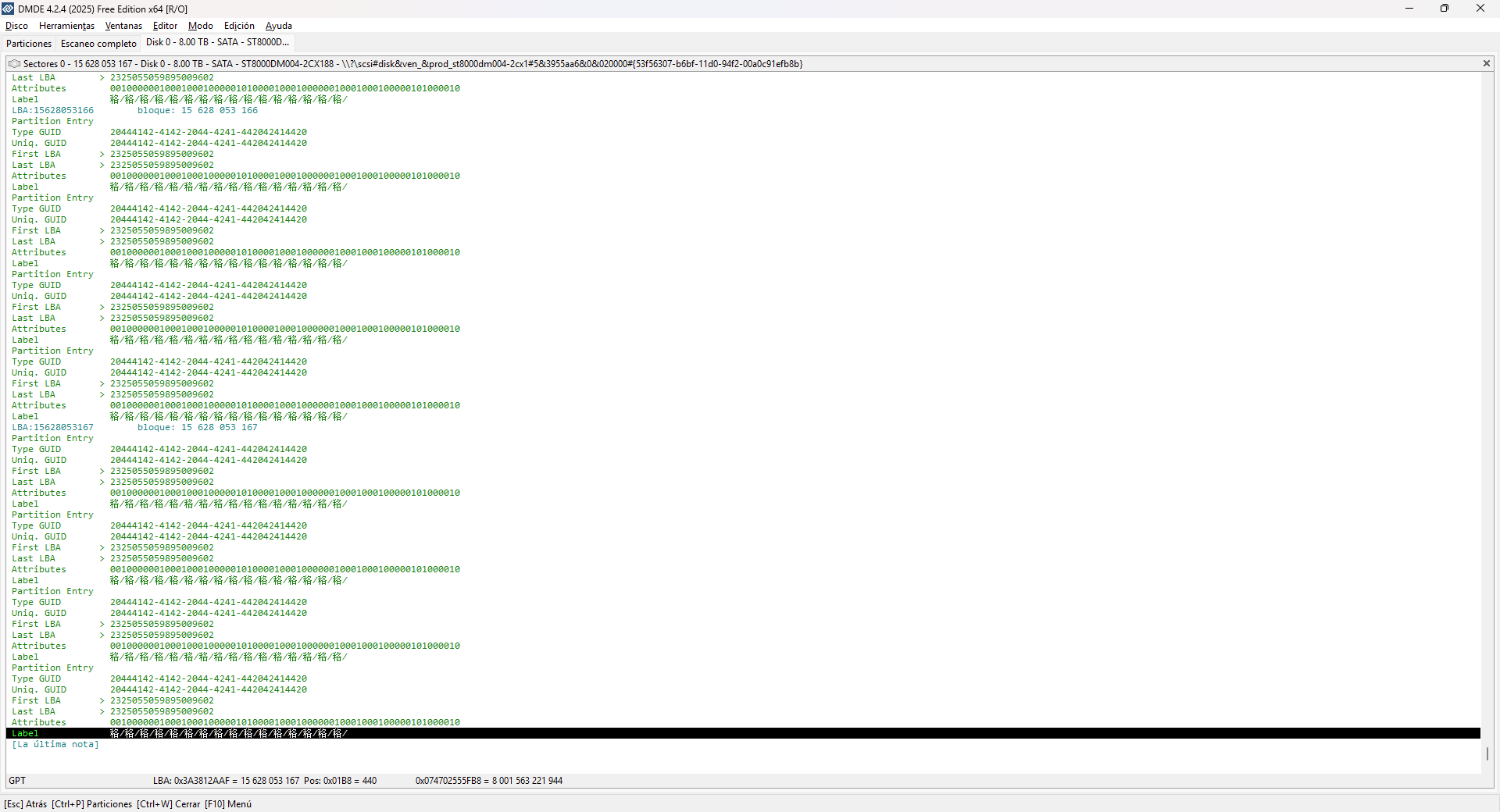

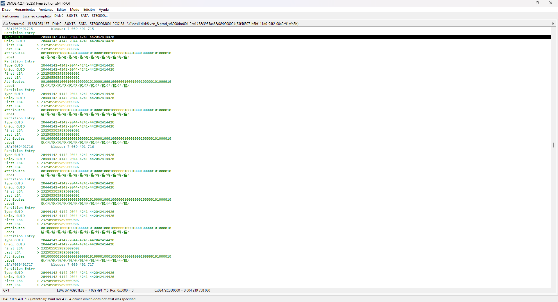

  2. Ludwing Erick Rodriguez Alvarez 10 Reputation points
    2025-08-26T04:59:59.2866667+00:00
    New finding, from the first to the last block, all the information is the same, it looks like an update without where
    User's image
    354d1e54-bfb6-469b-af22-2c0968a4fd4e
    d60051bc-f5ef-4e48-9036-7a293af19d39

  4. Igor Leyko 112.4K Reputation points Independent Advisor
    2025-08-26T01:42:29.55+00:00
    This is not 8 TB drive data. And please open Device manager and show a list of hard drives.
