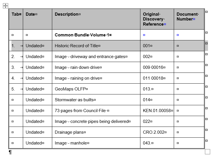

Hi - I have a table in a word 365 document that has been created with auto numbering the rows in the first left column. I now need to add additional rows throughout the document but do not want to have it add new row numbers (ie. want to keep the existing numbers as they are and just add a new row without the auto numbering). Currently adding new rows by shifting (right arrow) to far right of last cell in a row and hitting 'enter. How can i do this please?

  1. Charles Kenyon 171.3K Reputation points Volunteer Moderator
    2024-11-25T02:33:13+00:00
    WOW - as easy as that - simply allow word to create a new row then select the entire row and choose 'none' for a numbering style and everything reverts back to previous apart from having a new row with no automatic numbering (it was selecting the entire row that I wasn't doing before lol) - thank you so much :-)
    In a table, you actually only have to select the Cell or the numbered paragraph within the cell if there are multiple paragraphs.
  2. Charles Kenyon 171.3K Reputation points Volunteer Moderator
    2024-11-24T23:37:26+00:00
    Remove the numbering from the first cell of the row you no longer want numbered and rows below.

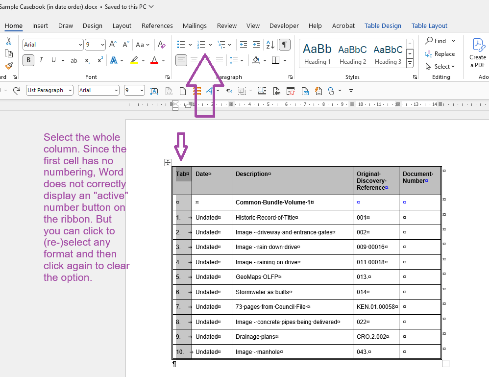

  3. Stefan Blom 354.1K Reputation points MVP Volunteer Moderator
    2024-11-25T21:15:07+00:00
    Select the whole first column. Word won't correctly display an "active" number format, because the first and second cells have no number format applied to them.
    However, you can choose any number format by clicking the number button, and then click the button a second time to remove the numbering from all cells.
    Or you can select only the numbered cells, as Charles suggested. :-)
