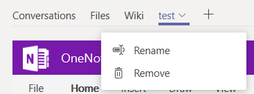

    Moreover, as far as I know, Notebook tab can be renamed, please tell me more details about your concern on changing channel name in Notes. And what do you want after changing name of a Team? Which area of Notebook to change as well, please capture a screenshot for further understanding.
