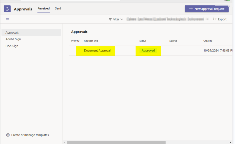

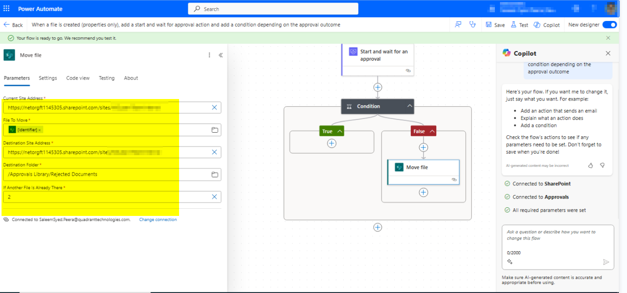

We successfully ran the flow on our end without errors, as shown in the attached screenshots. The issue you’re facing appears to be related to SharePoint locking the file when it’s open in the browser.
User's imageUser's image
To resolve this, please try the following:
  1. Close the Document before approving the request.
  2. Add a Delay before the "Move File" action to give SharePoint time to unlock the document.
  3. Set a Retry Policy on the "Move File" action to handle temporary locks effectively.
