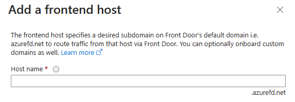

The AFD Classic SKU doesn't have a concept of endpoint. The frontend/host name that we add during deployment is both its hostname and profile name.
User's image

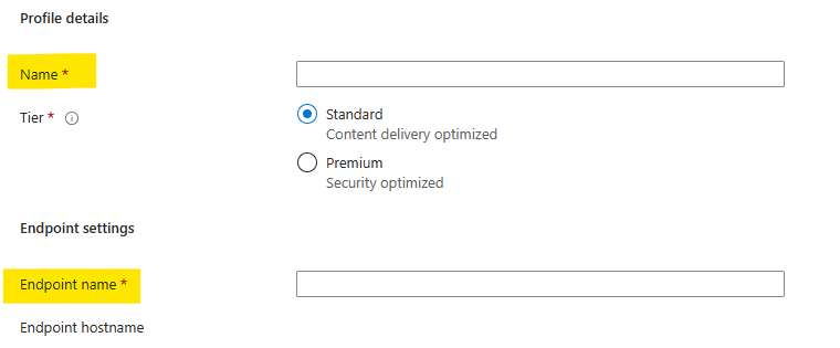

However, the Premium SKU has a concept of endpoint. The profile name and the endpoint/host name could be same or different in this case.
enter image description here
An endpoint is a logical grouping of one or more routes that are associated with domain names. A route contains the origin group configuration and routing rules between domains and origins. An endpoint can have one or more routes.

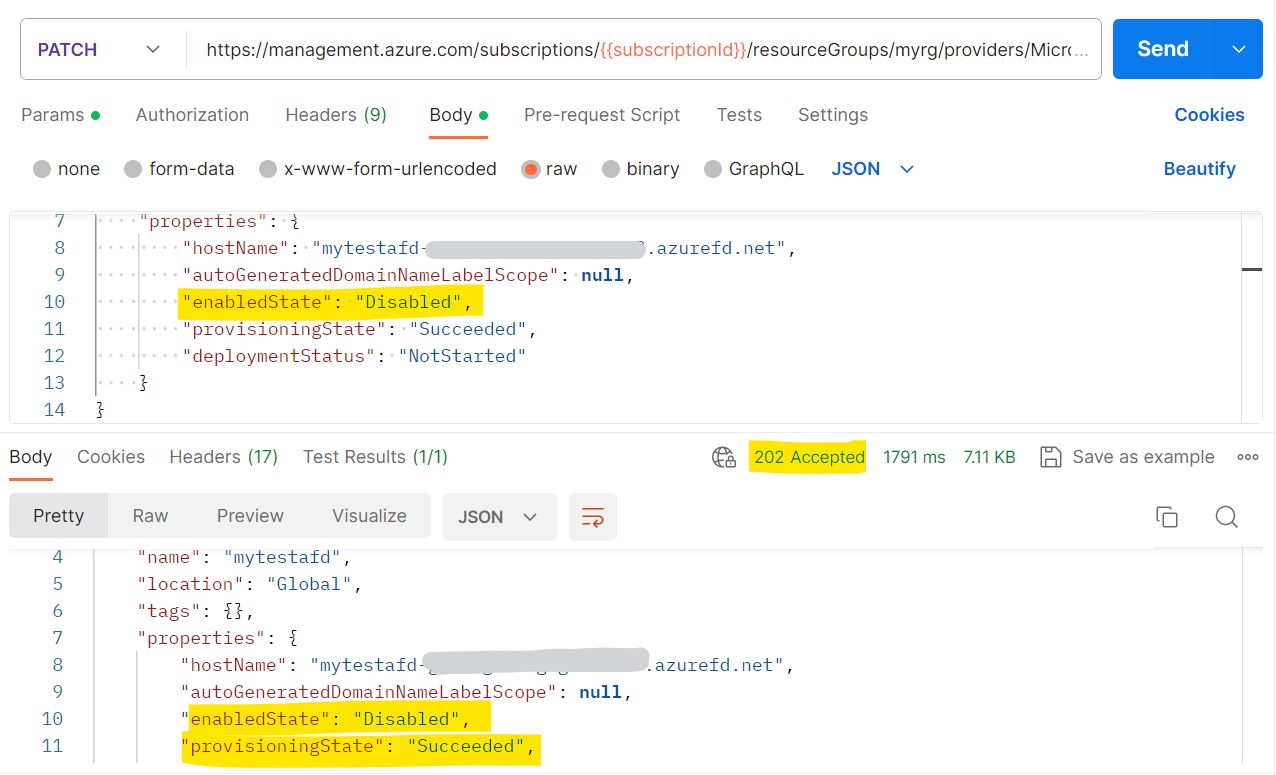

I tested this in my lab, and it works.

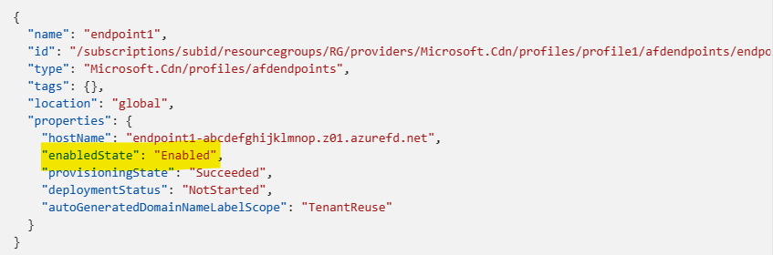

You need to do a GET on the AFD endpoint and then use the response you get as request body in the update Rest API.
You have to set the field marked below as Disabled in your request body. This field will be at the end of the JSON body.
If you've more than one endpoint, then disable all the endpoints to disable the Azure Front Door profile.
