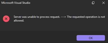

Hi all,
I am unsure where the correct place to post this would be.
We have started experiencing "Server was unable to process request. ---> The requested operation is not allowed." errors when trying to connect to repositories hosted on Azure DevOps.
What we have attempted:
  • Unlinking and relinking accounts.
  • Clearing the credential caches on the affected devices.
    • Also removing the credentials with the Credential manager.
  • Completely re-installing Visual Studio.
  • Reverting to the Windows version before the issue.
  • Confirmed via a swap test that the issue follows the specific device, not the user account
    • An affected user's account connects successfully on an unaffected device, and vice versa.
  • Verified HTTPS connectivity to both the legacy and dev.azure.com endpoints via curl
    • Succeeds without error on affected devices.
  • Confirmed WebView2 Runtime version and Windows build are consistent across affected/unaffected devices.
Reproduction steps:
  1. Open Visual Studio (2019, 2022, or 2026) on an affected device.
  2. Go to Team Explorer -> Manage Connections.
  3. Double-click an affected project / Right click -> Connect.
  4. Receive error dialog. Screenshot 2026-09-29 122524
Any advice on how to resolve this would be greatly appreciated.

Fredrick Johan van der Merwe 0 Reputation points
2026-09-30T08:19:02.1533333+00:00
As the issue appears to be with the legacy URLs.
We have decided to migrate all legacy URLs to the new format, which appears to have permanently resolved the issue.
