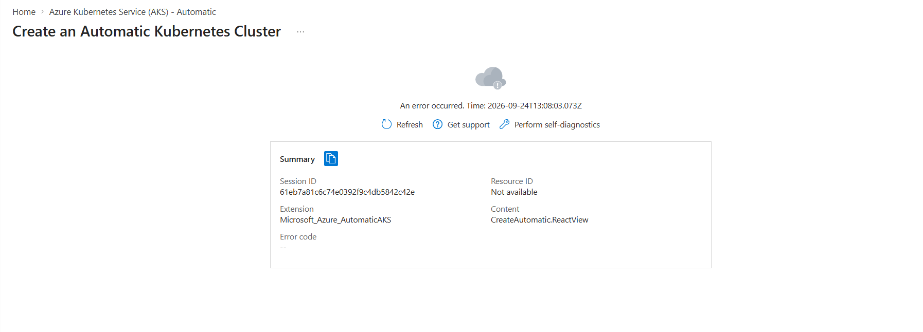

AKS Automatic cluster creation through the Azure Portal is currently failing.
When attempting to create an AKS Automatic cluster from Kubernetes Center → Create → Automatic Kubernetes Cluster, the portal returns a generic error during the creation process (Microsoft_Azure_AutomaticAKS / CreateAutomatic.ReactView) and the cluster is not provisioned.
The issue needs to be investigated to confirm whether there is a current Azure Portal/AKS Automatic service-side issue affecting cluster creation in Central US.
Able to create AKS standard
User's image
Session ID: XXX
Extension: Microsoft_Azure_AutomaticAKS
Content: CreateAutomatic.ReactView
Error Code: --
Resource ID: Not available

    Since Standard AKS creation works and the failure is occurring specifically in the "Microsoft_Azure_AutomaticAKS / CreateAutomatic.ReactView" portal experience, I would separate a portal/UI failure from an AKS Automatic provisioning failure before changing the subscription or region.
    Microsoft currently documents both the Azure portal and Azure CLI as supported methods for creating an AKS Automatic cluster.
    As a useful isolation test, try creating the same Automatic cluster from Azure Cloud Shell using a current Azure CLI:
    "az aks create --resource-group <resource-group> --name <cluster-name> --sku automatic --enable-hosted-system"
    Microsoft's current quickstart requires Azure CLI 2.86.0 or later for the documented Automatic workflow, so check:
    "az --version"
    If the CLI deployment succeeds in Central US, that would strongly isolate the issue to the Azure Portal Automatic AKS extension rather than regional AKS Automatic capacity or your subscription.
    If the CLI deployment also fails, capture the ARM/CLI error and correlation information because that will provide substantially more diagnostic information than the current portal error. The fact that the portal currently gives you no resource ID suggests there may not yet be an AKS resource against which to troubleshoot provisioning.
    I would collect:
    • subscription ID
    • resource group
    • region
    • exact UTC timestamp
    • Azure CLI version
    • CLI command result/error
    • portal Session ID
    • "Microsoft_Azure_AutomaticAKS" extension information
    and use those with Azure Support if both supported creation paths fail.
    I would not conclude from the current "CreateAutomatic.ReactView" message alone that Central US does not support AKS Automatic.

    Central US is currently a supported region for AKS Automatic, and the Azure Portal is a supported way to create an Automatic cluster.
    The Microsoft_Azure_AutomaticAKS / CreateAutomatic.ReactView message shown in your screenshot appears to be generated by the Azure Portal extension/view before a resource ID is created. However, I cannot find verified Microsoft documentation mapping CreateAutomatic.ReactView to a known AKS Automatic service incident or specific backend failure.
    To distinguish a portal issue from an AKS provisioning issue, do the following:
    • Check Azure Service Health for any AKS or Azure Portal advisory affecting your subscription/region.
    • Capture the Azure Portal diagnostic information while reproducing the error by pressing Ctrl+Alt+A. This generates PortalDiagnostics.json, including the portal session ID and diagnostic metadata useful to Microsoft Support.
    • Capture a browser trace if the error persists. Microsoft specifically recommends browser traces, console output, and portal diagnostic information when investigating Azure Portal failures.
    • As an isolation test, attempt AKS Automatic creation using the documented Azure CLI method rather than the Portal:
      • az aks create --resource-group <resource-group> --name <cluster-name> --sku automatic --enable-hosted-system
    If CLI deployment succeeds while the Portal consistently fails with CreateAutomatic.ReactView, that would provide useful evidence for Microsoft Support that the failure is specific to the Portal creation experience, not AKS Automatic provisioning itself.
