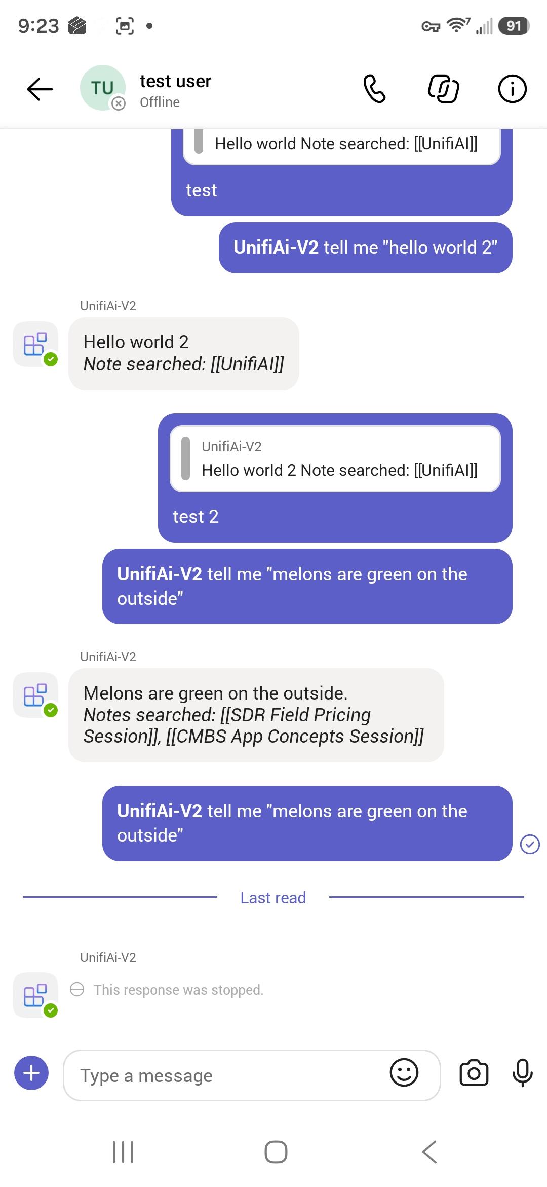

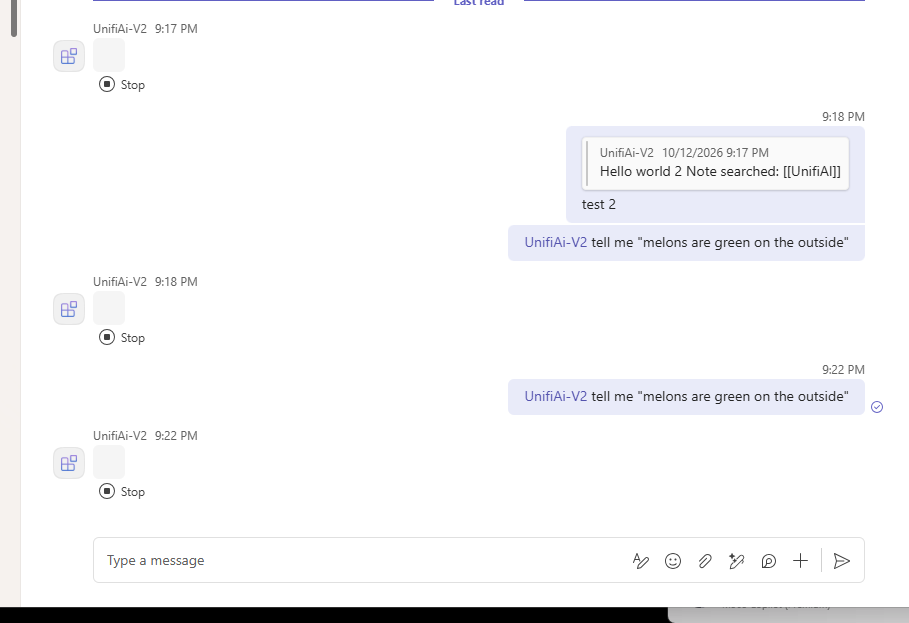

We have published an AI Foundry Agent to Microsoft Teams. The agent works correctly in the Web Chat (Playground), but responses never arrive in the Teams client.
Observed behavior:
  • Agent receives the first message from Teams (visible in AI Foundry Tracing)
  • Agent generates a response (visible in Tracing)
  • Response is never delivered to the user in Teams
  • Subsequent messages are also not received by the agent
  • Mentioning the bot via @botname in a Teams channel also does not work
