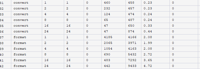

On SQL Server 2025 CU10 (17.0.5035.5, KB5125471, also seen on CU4), on Linux with 24 schedulers, a trivial SQLCLR scalar function called once per row in a parallel plan costs far more CPU per call as DOP rises, and the query is slower at DOP 24 than at DOP 1. The same check written in T-SQL scales normally.
The function is a SAFE assembly method that returns its integer argument plus one, marked deterministic and precise with no data access. The test counts the rows of a 2,000,000-row heap for which the function returns 0, with a MAXDOP query hint and the ENABLE_PARALLEL_PLAN_PREFERENCE hint.
CPU per call and elapsed time:
  • DOP 1: 0.17 microseconds, 350 ms
  • DOP 4: 0.22 microseconds, 116 ms
  • DOP 8: 1.95 microseconds, 496 ms
  • DOP 24: 7.94 microseconds, 702 ms
At DOP 24, sys.dm_os_spinlock_stats shows about 173 million spins on DIAG_OBJECT per run, against 0.9 million at DOP 4, and nothing comparable for the T-SQL version. Turning lightweight query profiling or Query Store off in the database makes no difference. Only the default Extended Events sessions are running.
A second effect: if the function's string parameters are declared nvarchar(max) rather than nvarchar(4000), the call costs about 6 times as much even at DOP 1, and from DOP 2 up it spins on SOS_SELIST_SIZED_SLOCK and SOS_CACHESTORE instead, up to 24 microseconds per call at DOP 24. Those are the spinlocks KB2887899 describes for spatial index builds.

    I was able to reproduce your results. I also tested on SQL 2012, and the outcome was largely the same. Thus, this does not seem to be any recent regression.
    I don't want to venture to answer the first two questions as they require knowledge from the inside that I don't posses. As for the third question, I think the results speak for themselves. I note that in terms of elapsed time, MAXDOP 4 appears to be the sweet spot. The fact that queries do not always benefit from higher DOP is not unique to CLR queries, but this can be seen with other queries as well. This is why Microsoft introduced DOP Feedback which first came in SQL 2022, but did not become a mainstream feature until SQL 2025.
    However, that feature does not seem to help in this case. I tried, but nothing happened. (Running queries as such without any hints.) When I set up an Extended Events session with the events for dop_feedback, the query came up with eligible=false. This does not seem to have to do with the CLR as such, though, because I got the same result with your control query, that is
    select count(*) /*clrspin IsMarkedMax dop8 run3*/ from dbo.T where substring(Code, 4, 1) = 'M'
    I also tried adding two T-SQL functions for which I had turned off inlining. Here the results were entirely different. And worse. That is, a T-SQL UDF prevents parallelism entirely. TSQL4000 was also considerably slower than IsMarked4000.
