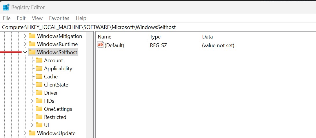

Am going to assume you already are on Build 26300.9550. Please press Start and type winver and post the popup window.
Try deleting the entire WindowsSelfHost Key. It will be rebuilt after a reboot:
HKEY_LOCAL_MACHINE\SOFTWARE\Microsoft\WindowsSelfHost
_AllowTelemetry-SelfHostKey
Delete the entire Selfhost key and reboot your device. Check if the Windows Insider page asks you to join. You should be out of Insider unless you are using a 28xxx or 29xxx build.
After you delete the Host Key since you are on 26220.8283, dl the ISO image from here
https://www.microsoft.com/en-us/software-download/windows11
Mount the image file within Windows by right clicking on the ISO and run Setup.exe within windows thus doing a Repair install. This will let you keep all files, etc.
