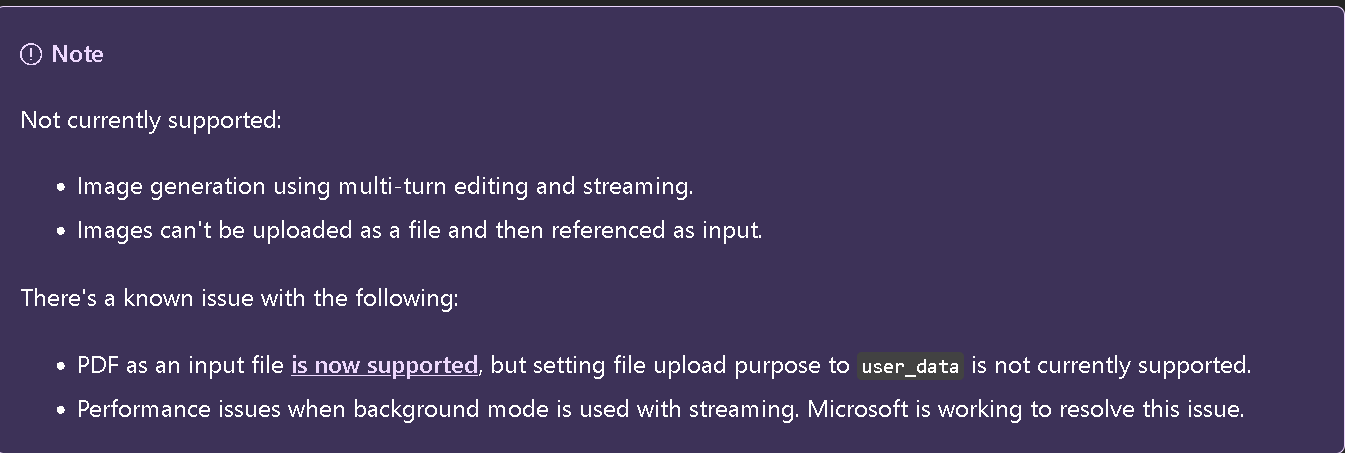

  1. Isak Tellström 0 Reputation points
    2026-08-12T14:28:34.5+00:00
    Not sure how helpful this is since you didnt include it in your question but if you're running it in background mode there seems to be a known performance issue when having streaming enabled.
    User's image
