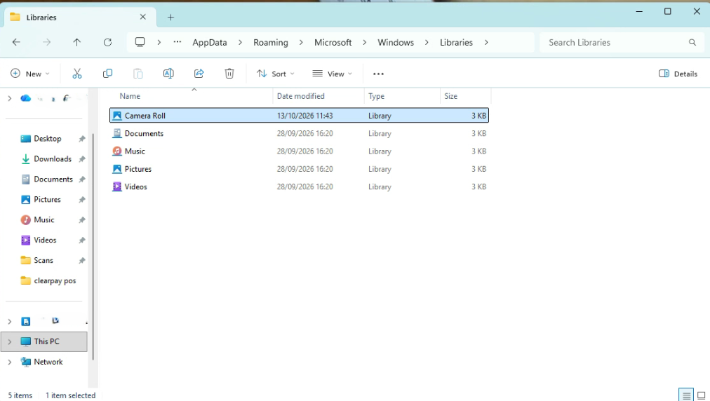

While investigating, I noticed that Camera Roll was accessible through the following location:
C:\Users\<Username>\AppData\Roaming\Microsoft\Windows\Libraries\Camera Roll

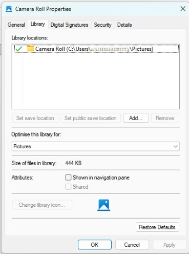

When I checked the Camera Roll library properties, the configured location was pointing to:
C:\Users\<Username>\Pictures
rather than the expected OneDrive location:
C:\Users\<Username>\OneDrive - <Organisation>\Pictures\Camera Roll

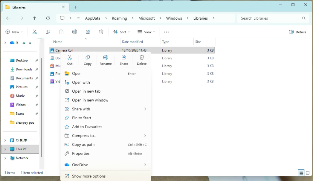

Step 1: Open the Windows Libraries folder
  1. Open File Explorer and navigate to: %APPDATA%\Microsoft\Windows\Libraries
  2. Locate the Camera Roll library. img_1 img_2

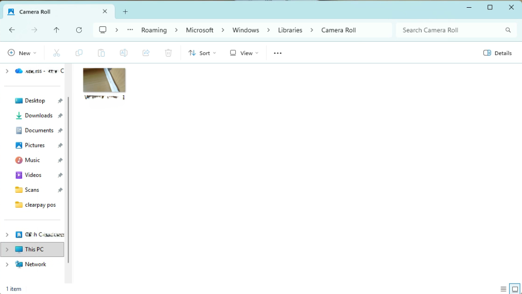

Step 2: Open Camera Roll Properties

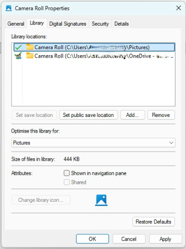

  • Right-click the Camera Roll library and select Properties. img_3
Step 3: Check the configured library locations
  • Under the Library tab, review the folders currently included.
  • On the affected computer, the library was referencing: C:\Users<Username>\Pictures rather than the intended OneDrive Camera Roll folder. img_4

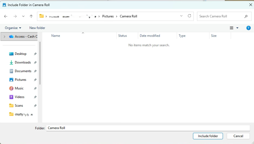

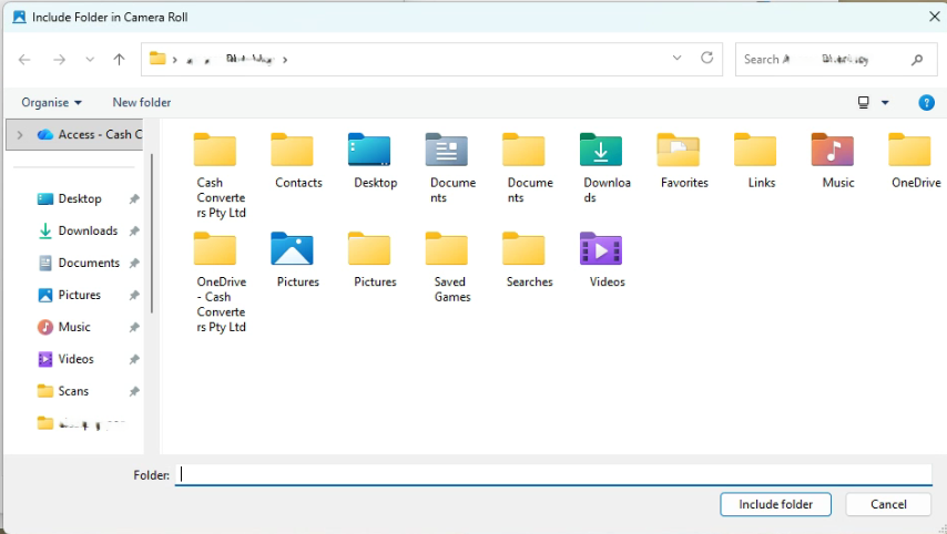

Step 4: Add the correct OneDrive Camera Roll folder
  1. Click Add....
  2. Navigate to your organisation-managed OneDrive directory, then open: Pictures\Camera Roll For example: C:\Users<Username>\OneDrive - <CompanyName>\Pictures\Camera Roll
  3. Select the folder and click Include folder. img_5 img_6

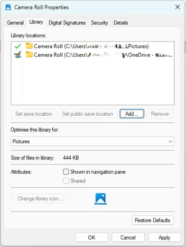

Step 5: Remove the incorrect location
  1. The library should now show both the original local Pictures location and the newly added OneDrive Camera Roll location.
  2. Select the original local Pictures entry and click Remove.
Note: Be careful to remove only the library reference, not the physical folder or any photographs stored in it.

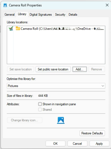

Step 6: Apply the changes
  1. Confirm that the intended OneDrive Camera Roll folder is the remaining library location.
  2. Click Apply, followed by OK. img_9

  • It is also worth noting that Windows stores library definitions in the AppData directory. Seeing Camera Roll under AppData\Roaming\Microsoft\Windows\Libraries does not necessarily mean the actual photographs are physically stored there.
The important distinction is between the library's displayed contents, its configured locations, and the actual storage destination used by the Camera application.
