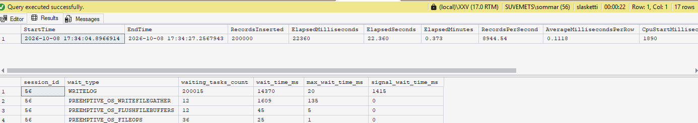

    This will give you an idea of what SQL Server has been waiting for. For reference, this is the result when I ran your script (without transactions added) on my SQL 2025 instance on my desktop computer at home (no VM):
    User's image
