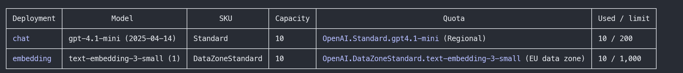

Model deployment blocked during ARM resource-provider preflight validation. I am getting errors when attempting to deploy a resource group-scoped deployment stack containing a Microsoft.CognitiveServices/accounts resource with API version 2025-06-01. The deployment fails during the stack preview and deploy, and the error message indicates that the template is not valid according to the validation procedure, with details referencing a failure in the deployment stack operation status in Sweden Central. This template has an ai foundary account with 3 projects and 2 deployment models for chat and embeddings. Validation works with ai foundary alone. ai foundary + 3 projects. but when models are included I get this error.
