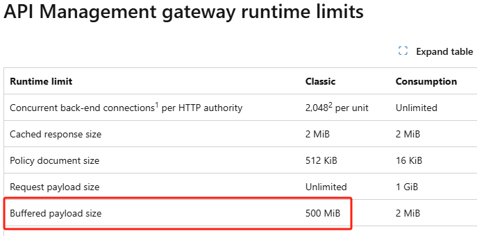

    Azure APIM has several JSON payload limits that apply depending on your tier and what policy you're using, and each can be tuned differently.
    Understanding the Default Limits
    There are three distinct limits at play in APIM:
    Maximum request payload size — up to 1 GiB (Developer, Basic, Standard, Premium tiers); only 2 MiB on Consumption tier
    Maximum buffered payload size — 2 MiB on all tiers. This is the key limit when policies need to read or modify the request/response body using context.Request.Body or set-body — if the body exceeds this, APIM cannot buffer it in memory for policy processing

    If your concern is about policies like set-body or context.Request.Body.As<JObject>() failing on large payloads those are bounded by the 2 MiB buffered payload limit which cannot be increased. For payloads exceeding 2 MiB that need transformation, the recommended pattern is to avoid buffering by using streaming or routing to a backend service that handles the transformation outside APIM.
