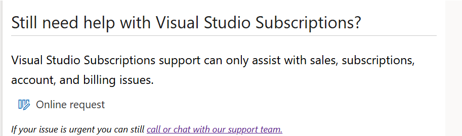

    In that case, please contact the Visual Studio Subscriptions Support team by creating a support case from the Get Help section of the Visual Studio Subscription Portal :

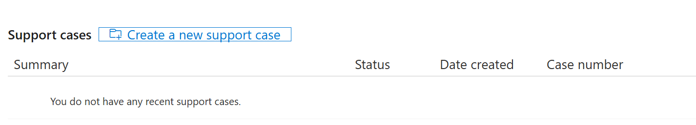

    1. Create a support case: User's image

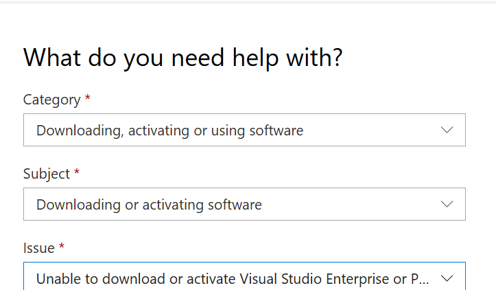

    2. Fill all fields that match your situation: User's image
    3. You can also create Online Request here: User's image
