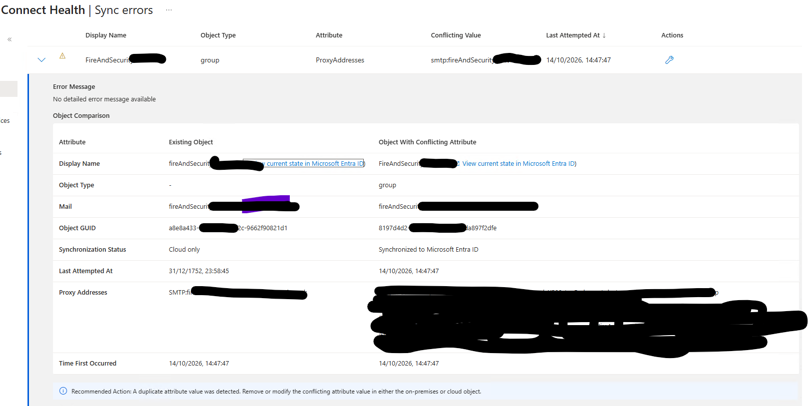

We had an onPrem dynamic distribution group which was deleted, and then a normal onPrem distribution group was created with the same email aliases.
Just one of the aliases wont sync to azure, showing error as below. All the other aliases (and there are a few) all sync fine.
How can i delete the orphaned 'Cloud Only' object from azure to allow me to use this alias on the new distribution group, please?

    Thank you for sharing the screenshot and explaining your hybrid Exchange environment.
    From the Microsoft Entra Connect Health screenshot, I can see that the synchronization error involves a duplicate proxyAddresses value between an existing Cloud Only object and your newly synchronized on-premises distribution group.
    Since the previous dynamic distribution group was deleted and a new distribution group was created using the same aliases, it is possible that an existing cloud object is still retaining the conflicting SMTP address.

  2. AI answer
    2026-10-14T14:42:02.84+00:00
    This is consistent with an orphaned Microsoft Entra group object holding that proxy address.
    Use this sequence:
    1. Force a full sync first to confirm the deletion is not just pending:
    Start-ADSyncSyncCycle -PolicyType Initial
    1. If the alias still does not sync after the cycle completes, remove the orphaned cloud group object from Microsoft Entra ID.
    2. Connect to Microsoft Graph PowerShell, locate the conflicting group, and delete it.
    Example:
    Connect-MgGraph
    $group = Get-MgGroup -Filter "mail eq '******@contoso.com'"
    Remove-MgGroup -GroupId $group.Id
    If the conflict is specifically on a proxy address rather than the primary mail value, identify the cloud-only object shown in Connect Health / sync errors, then remove that group by its GroupId.
    1. Run sync again after deletion so the new on-premises distribution group can stamp the alias into Microsoft Entra ID.
    Important:
    • Deleting the wrong cloud object is destructive. Verify the object is the cloud-only orphan before running Remove-MgGroup.
    • Synced distribution groups must be managed on-premises. Changes made there are synchronized to Microsoft 365 on the next sync cycle.
    If the object is not actually cloud-only and is still shown as synchronized from on-premises, delete or correct it in the on-premises Exchange/Active Directory management tools instead of deleting it in Exchange Online or Microsoft Entra ID.
