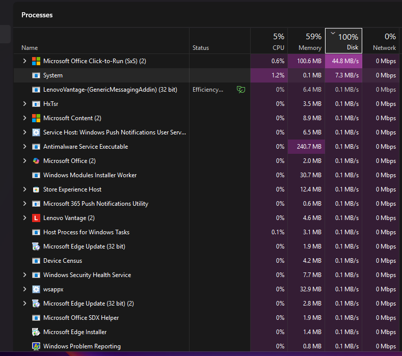

  1. Igor Leyko 112.4K Reputation points Independent Advisor
    2026-10-04T17:29:38.6466667+00:00
    Seems the problem is caused by Microsoft Offive installation. Try to repair Office installation. What exactly Office version do you have?

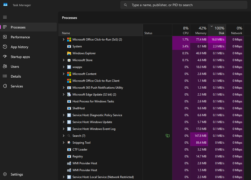

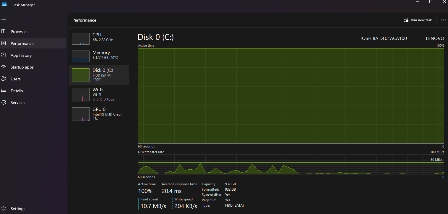

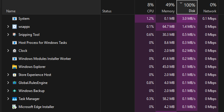

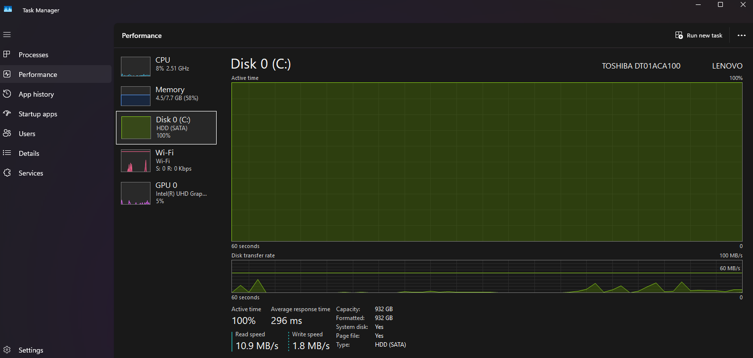

  2. Old observer 245 Reputation points Volunteer Moderator
    2026-09-29T20:39:05.3933333+00:00
    Drive is in good physical condition.
    Please run Task manager, go to Performance tab, select Disk C:, and show a screenshot with high disk load.
    Check if the problem exists during clean boot. https://support.microsoft.com/topic/how-to-perform-a-clean-boot-in-windows-da2f9573-6eec-00ad-2f8a-a97a1807f3dd

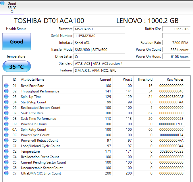

  4. Old observer 245 Reputation points Volunteer Moderator
    2026-09-26T22:26:18.6866667+00:00
    Please check drive's health with third-party CrystalDiskInfo tool and show its window.
