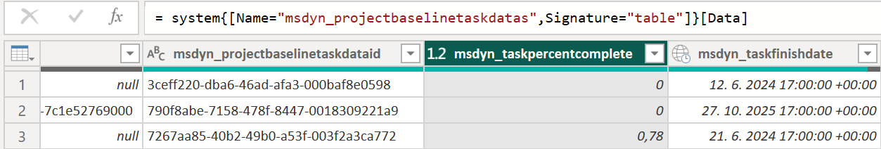

  1. Mayer 0 Reputation points
    2026-09-22T14:34:17.6866667+00:00
    User's image
    If you are using Plan P3, you can save a baseline, and you will find the correct task completion percentage in the msdyn_projectbaselinetaskdatas table.
    Naturally, the task completion percentage in the ProjectTask table will remain at 0. To recalculate this value, you must run the scheduling engine—for example, by editing the link between the task in question and its predecessor.
