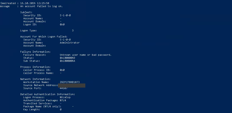

Since ~12 Oct 2026 23:53 UTC, all onboarding moves (Exchange 2019 CU15 -> Exchange Online, Modern Hybrid / Hybrid Agent) fail with TooManyTransientFailureRetriesPermanentException / CommunicationErrorTransientException right after "Connected to target mailbox". Test-MigrationServerAvailability still succeeds.
  • The start time matches the EXO MRS servers moving from build 15.21.496.x to 15.21.522.x.
  • IIS: POST /EWS/mrsproxy.svc -> 401 1 2148074252.

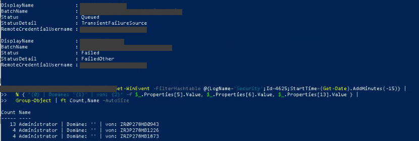

  • Event 4625 on the Exchange server: Account Name "Administrator", Account Domain empty, Sub Status 0xC000006A, NTLM, Workstation = EXO server.

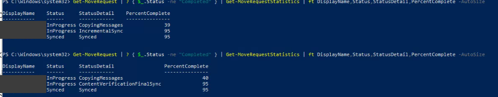

  • The configured endpoint account (dedicated service account, also tried UPN format) is ignored, even though RemoteCredentialUsername on the move requests shows it.

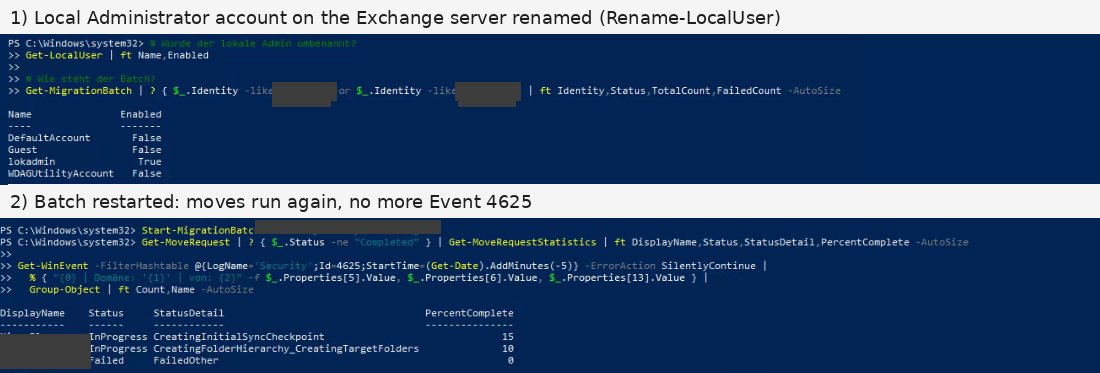

Workaround that made us succeed with the migration at the end: renaming the local Administrator account on the Exchange server makes the moves work again.

    Workaround We renamed the local Administrator account on the Exchange server(s). After that, no more 4625 events appear for this account, the 401 responses are gone, and our migration batches complete normally again.
    Same conclusion as the original poster: the credentials configured on the migration endpoint seem not to be used for these logons, and the failed attempts appear to come from the Exchange Online side. This looks like a service-side change rather than a local MRSProxy configuration issue, but only Microsoft can confirm that.

    Came here to say thank you - I was in the middle of migration efforts and that ish has been broken since last week and thought for sure it was something I broke, but nope, MIcrosoft at it again. Renamed the local admin account to something else as suggested by OP, reset the Exchange Rep Service just to be sure, and then Migration finally worked right away.
