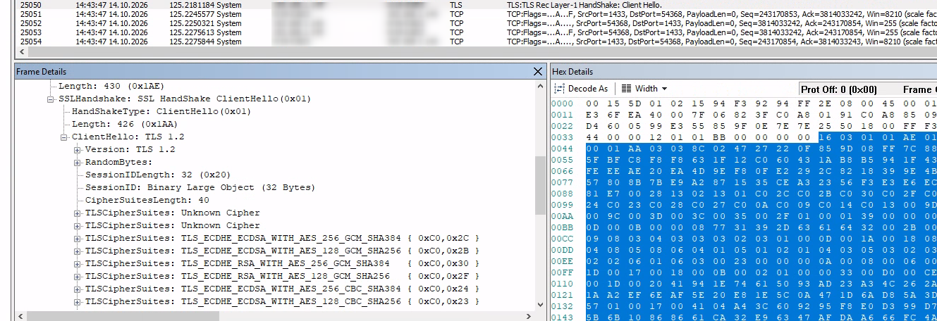

I get this error when logging in to an SQL Server instance:
ssl provider error 0 an existing connection was forcibly closed by the remote host error 10054
That happened after I added a certificate to that instance.
The same certificate works on other servers.
I've tried a few different things. After running a trace analysis, I found that there is no response during the TLS handshake.
A “Client Hello” is successful. The “Server Hello” is missing.

    Diagnosis
    The client sends its Client Hello and the server never answers. That means Schannel on the server rejected the handshake before replying. The cause is the server's certificate or TLS configuration, not the network or the client.
