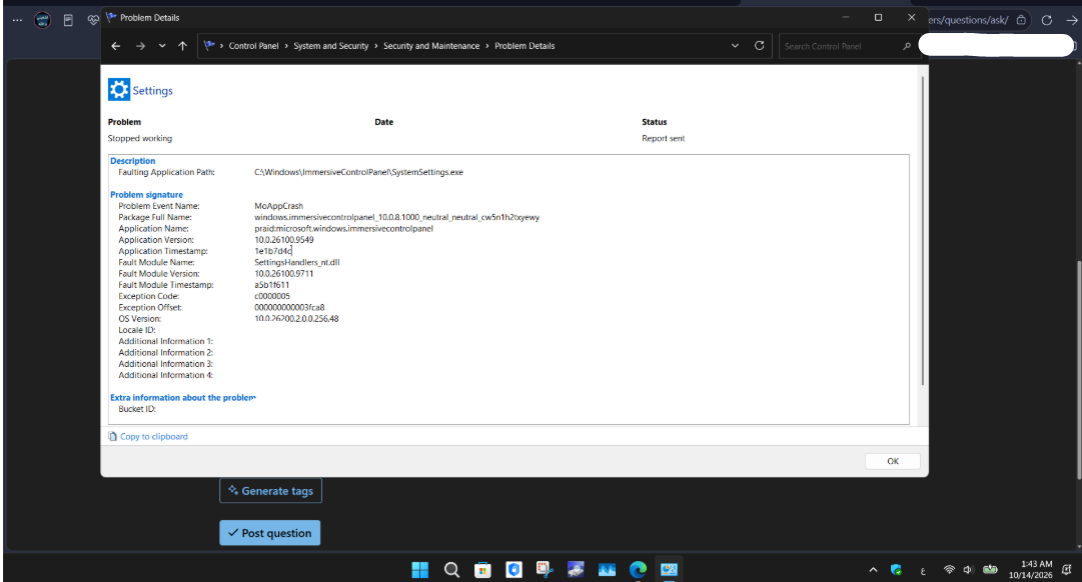

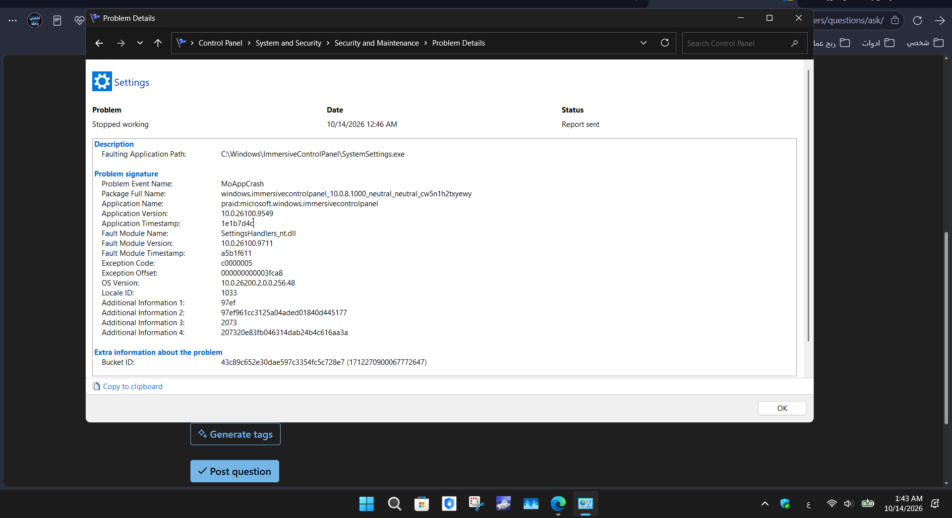

Problem Details & Crash Log (Reliability Monitor):
User's image
Observed Behavior:
Navigating to Settings > Personalization > Lock screen or clicking on the toggle/selector for lock screen status/widgets causes SystemSettings.exe to close abruptly.
The crash is driven by an Access Violation (0xc0000005) inside SettingsHandlers_nt.dll at offset 000000000003fca8.
Performing a System Restore to a clean state temporarily resolves the issue, but it reoccurs after about 1–2 hours as background cloud content tasks (ContentDeliveryManager) refresh user profile settings.

Thanks for sharing such a detailed report and the Reliability Monitor information. You’ve already completed the main system checks, restored the system, and re-registered the related components, so I don’t want to send you through the same steps again.
The report confirms that SystemSettings.exe is crashing in SettingsHandlers_nt.dll with exception code 0xc0000005. However, the crash details alone don’t confirm whether ContentDeliveryManager or cloud-delivered content is the underlying cause.
