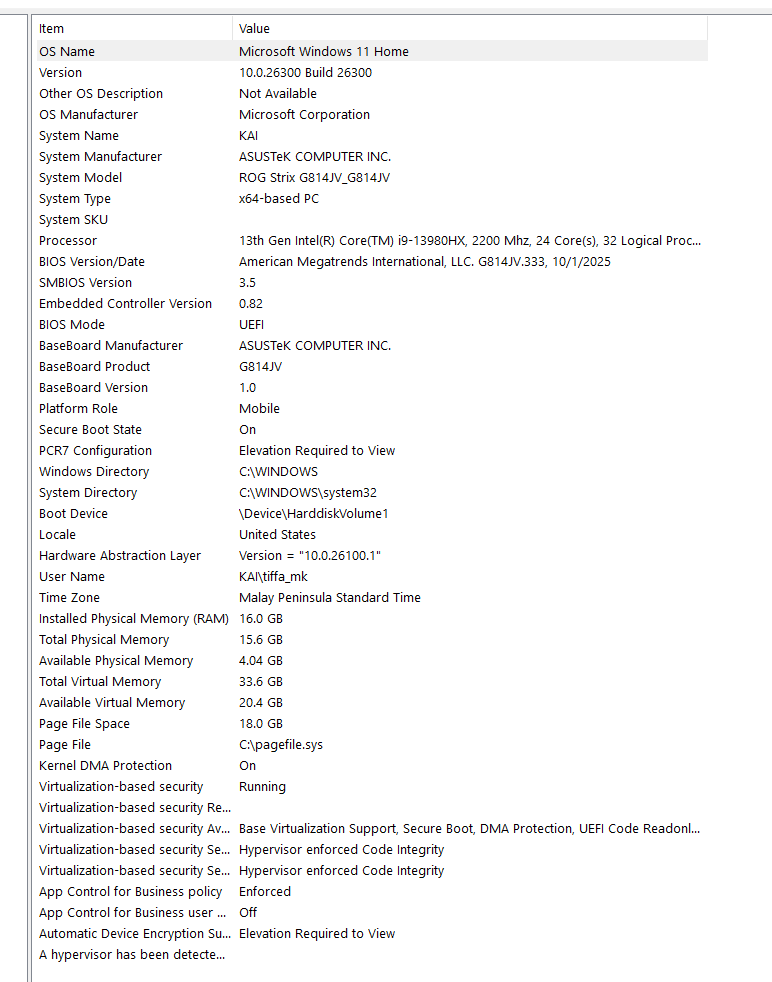

Here are my specs:
Installed RAM 16.0 GB (15.6 GB usable)
Graphics card NVIDIA GeForce RTX 4060 Laptop GPU (8 GB)
Intel(R) UHD Graphics (128 MB)
Storage 417 GB of 954 GB used
System type 64-bit operating system, x64-based processor
I am currently using a ROG laptop.

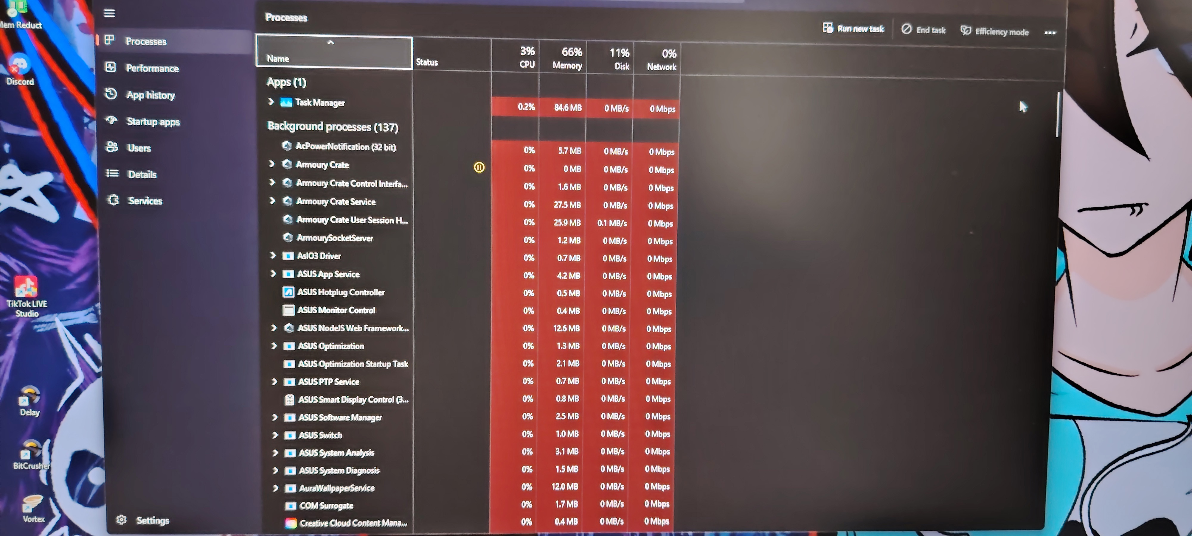

DaveM121 937.2K Reputation points Independent Advisor
2026-10-04T08:06:09.64+00:00
All your minidump files indicate a driver associated to your Intel processor is causing your system to crash.
You indicate your CPU sits at 65%+ on idle, that should not be happening, your processor should idle at 0% - 5% on idle and this may be related to the system crashes.
Restart (not shut down) your system to flush out your ram and let your system idle and do not open any apps.
Open Task Manager, then select the Processes tab.
If your CPU is the idling at a high percentage, click the CPU column header so the arrow on that header points down.
Please provide a screenshot of that Processes tab.
