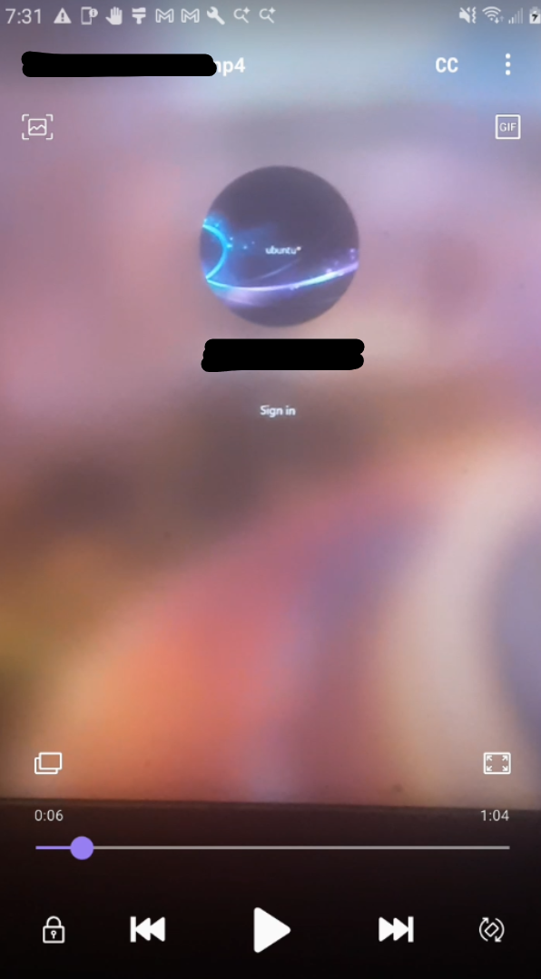

(This happens this morning) When I woke up, I turned on my computer, but after the login page, I get this button "Sign in". I was confused on what's going on. It takes me to the Microsoft sign in page, but I see no passkey on the list, so I signed in manually with a password. When I signed in, it boots normally. But then task manager stops responding when opened, some games don't respond. I set the pin, and tried restarting it multiple times to see if it really applies. Instead of showing the pin box, it shows "Sign in" again. I didn't know what was going on.

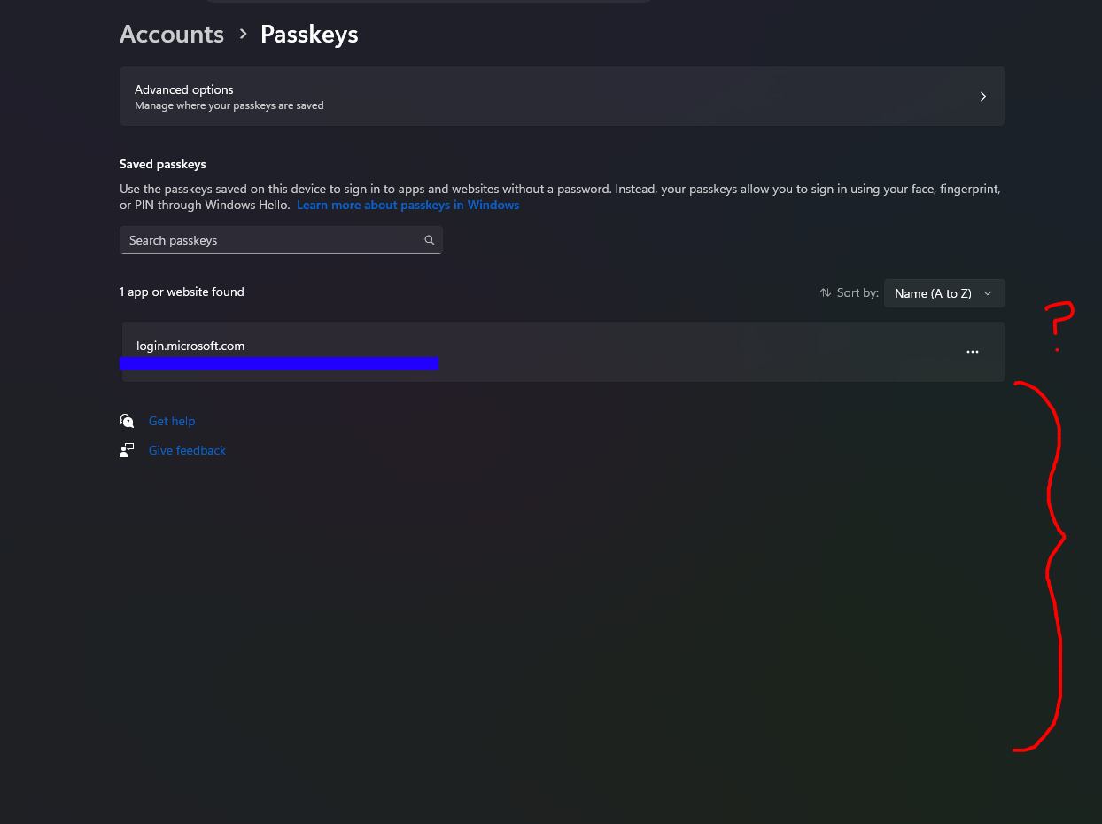

The more worse part was: All of my saved passkeys are just gone in settings.

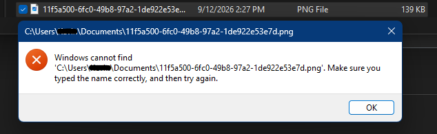

    What I am worried about was: I am not sure if my pin would restore on an update automatically (the pin aren't back), also my passkeys aren't in settings still. And the image file when trying to open in file explorer did not resolved yet.
    Note: The "sign in" still happens.

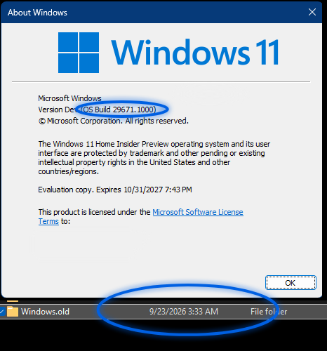

    Just a head's up that your Canary/Future
    build is behind. We are now up to 29671.
