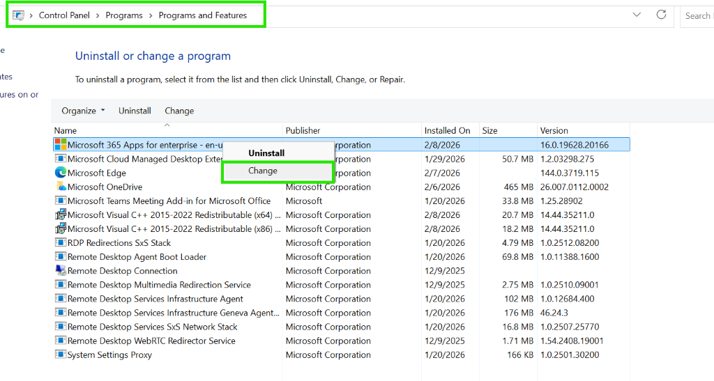

    May I ask if you've already tried running an Online Repair of Microsoft 365? If not, it would be worth testing, as it can replace corrupted Office components that aren't corrected by Safe Mode.
    You can do this by following these steps:
    • Close all office apps completely.
    • Go to Control Panel > Program > Programs and Features
    • Right click on the Microsoft Office you've installed > Change.

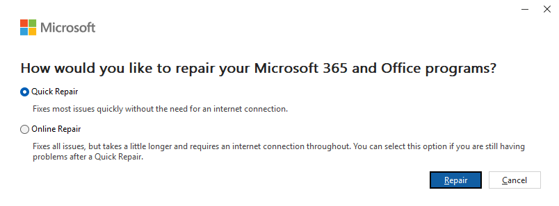

    • Select Quick Repair first (fast and doesn’t require internet).
    • If the issue persists, run Online Repair (requires internet and takes longer).
