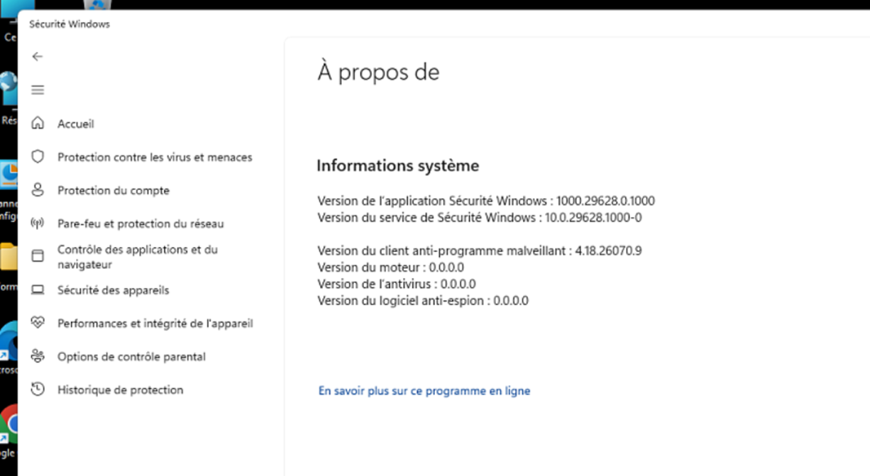

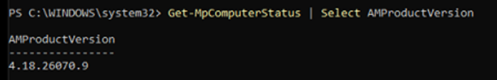

    Step 1: Verify the Actual Windows Security Platform Version on an affected device
    4.18.26070.9
    or 1000.29628.0.1000
    User's image
    User's image

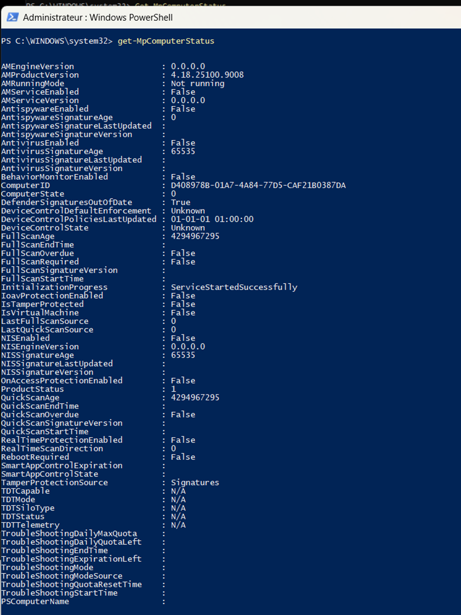

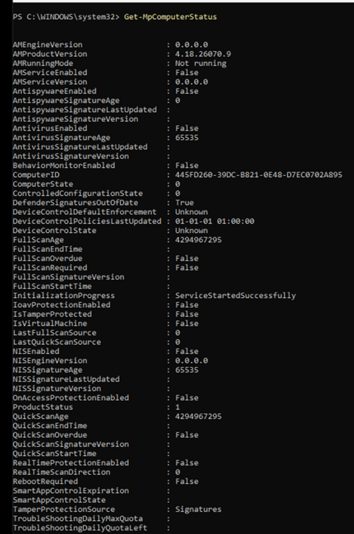

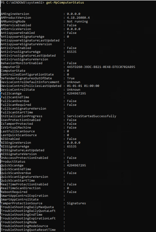

    Step 3: Verify Defender Platform Files
    On an impacted device:
    User's image
    On a healthy device:
    User's image
    on another healthy device:
    What is strange is that the version is newer on the affected device than the one on another computer on which i installed it manually thanks to the workaround:

    Hello Chance,
    Thank you for your reply, and sorry for my late answer.
    Here are the results from your queries:
    4.18.26070.9
    User's image
    User's image Step 2: Check Windows Update Detection State

    • There are no issues in the event viewer.
    User's image
    User's image on another healthy device:
    User's image
