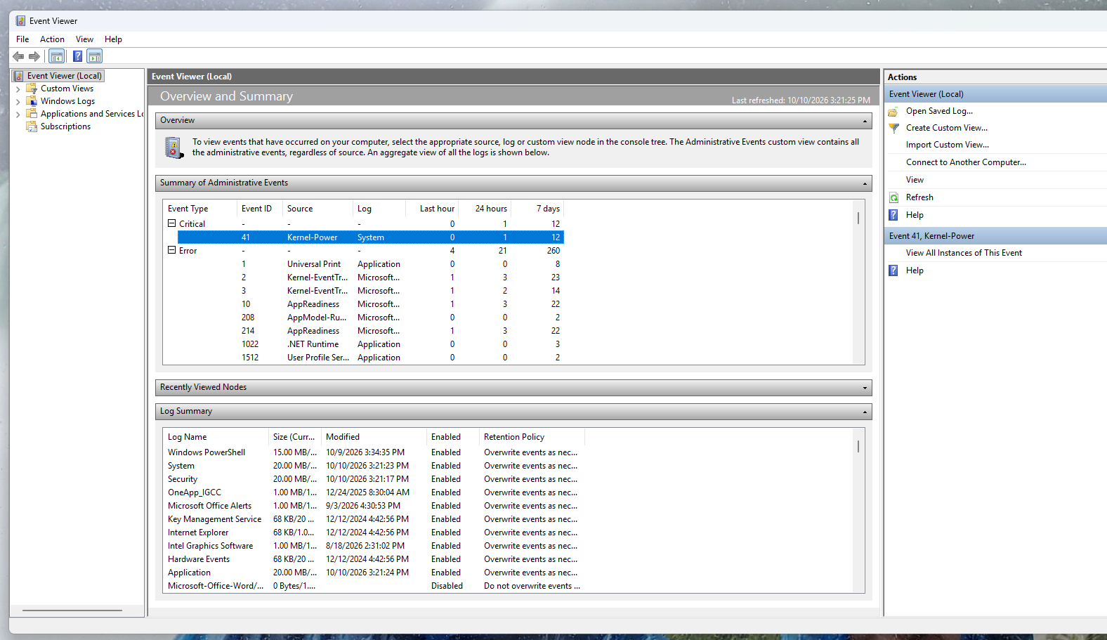

    The Event ID 41 shown in the screenshot records the forced reboot rather than identifying what caused the preceding black-screen freeze, so first determine whether the next occurrence is a recoverable graphics failure or a complete system hang.^1^
    At the next black screen
    Before forcing a reboot:
    1. Press Windows + Ctrl + Shift + B.
      • A beep, screen flicker, or restored picture means Windows successfully reset the graphics driver.
      • Microsoft specifically recommends this shortcut for black-screen conditions.^2^
    2. Press Ctrl + Alt + Delete.
      • If the security screen appears, Windows is still running and this is more likely confined to the display stack or another application.
    3. Press Caps Lock and check whether its keyboard light changes.
      • If it does not respond, Microsoft classifies this as a possible hard hang rather than merely lost video output.^1^
    A power-button shutdown may be unavoidable during a hard hang, but it should remain the last resort because it interrupts normal Windows shutdown.
    Inspect the useful Event 41 fields
    The Event Viewer summary does not show enough detail to diagnose the crash:
    1. Open Event Viewer → Windows Logs → System.
    2. Locate the Kernel-Power, Event ID 41 entry matching the reboot.
    3. Open it and select Details → Friendly View.
    4. Record:
      • BugcheckCode
      • PowerButtonTimestamp
      • BugcheckParameter1 through BugcheckParameter4
    5. Also inspect the Application and System events immediately before Event 41, particularly display-driver, WHEA, disk, or volmgr events.
    Interpretation:
    • Nonzero BugcheckCode: Windows recorded a stop error; that code and any memory dump are the next diagnostic targets.
    • Zero BugcheckCode: no stop code was captured. This can occur with a hard hang, sudden power loss, or a failure too abrupt to write diagnostic data.
    • Event 46 from volmgr: crash-dump initialization failed; check the page-file configuration because Windows may have been unable to create a dump.^1^

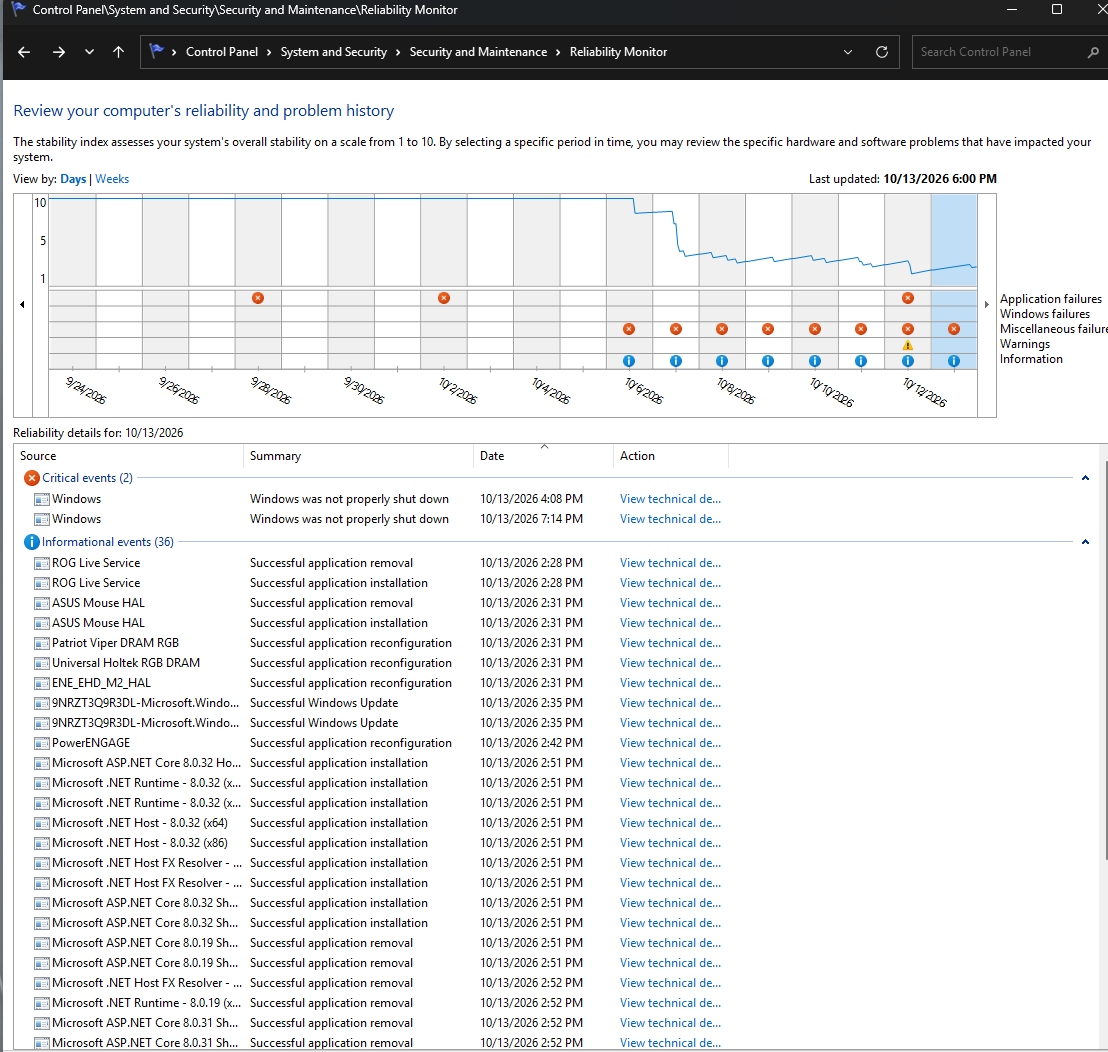

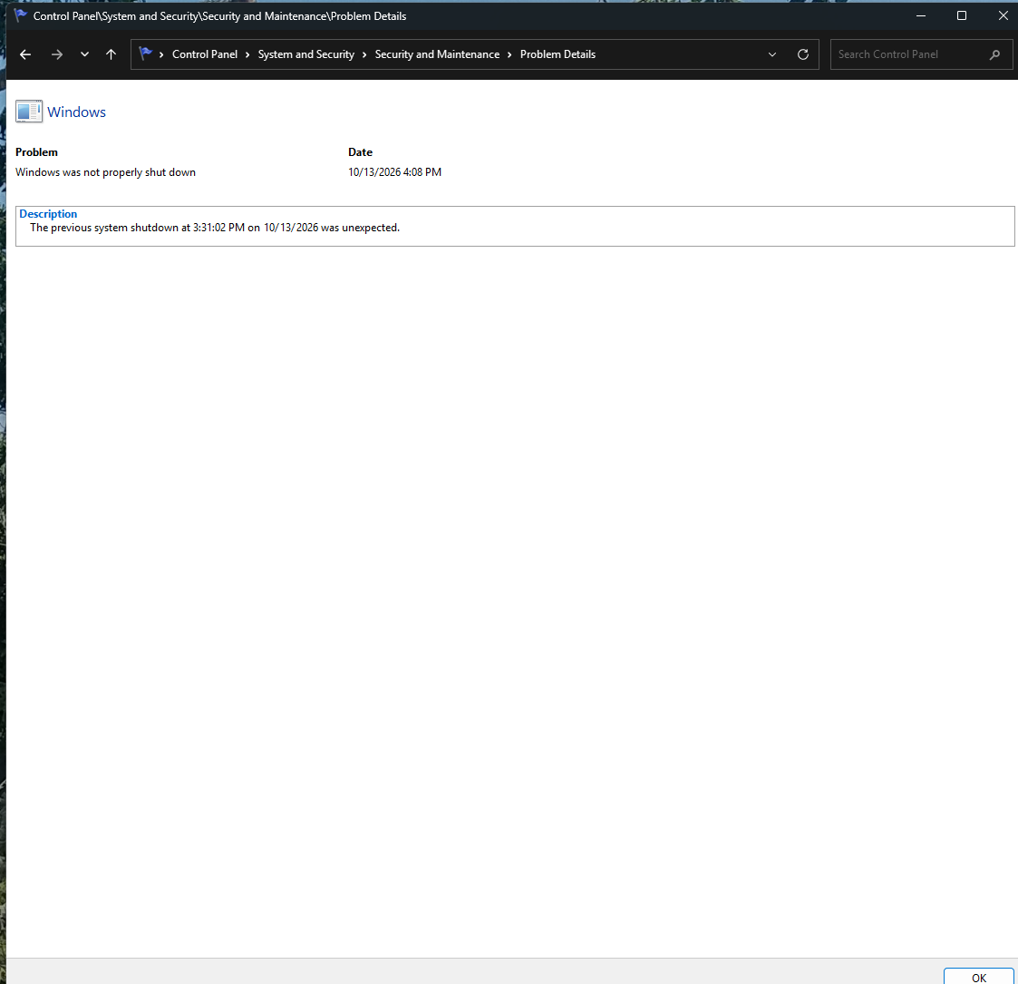

  2. Hendrix-V 20,300 Reputation points Microsoft External Staff Moderator
    2026-10-11T04:19:05.1+00:00
    Hi Chris R,
    The fact that the black screen can occur after Final Fantasy XIV, long Facebook videos, and the screensaver makes it worth checking the failure evidence rather than focusing on one application.
    After the next freeze/restart, please try:
    • Open Reliability Monitor.
    • Check the time of the black-screen event.
    • Look for entries such as an application failure, Windows failure, or hardware error.
    • Share the technical details from the matching entry.
    You can also try Win + Ctrl + Shift + B during the black screen to see whether resetting the graphics driver restores the display.
    This should help narrow down whether the issue is limited to the graphics/display path or whether the system itself is becoming unresponsive.

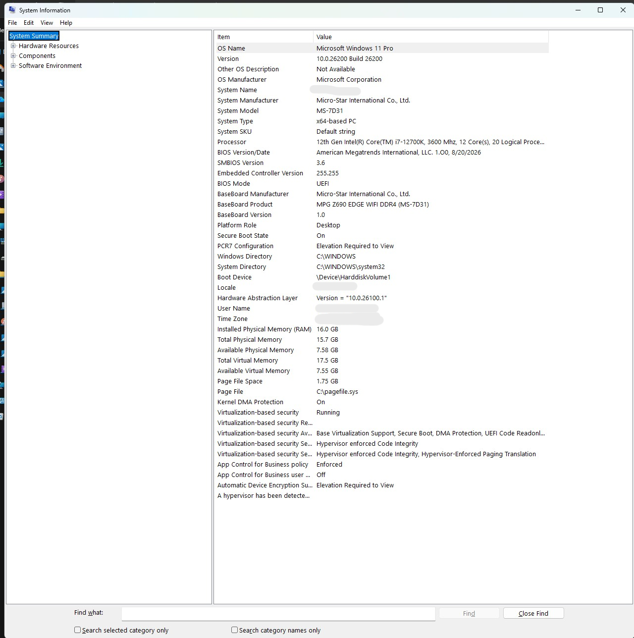

  3. Ivan B 125.1K Reputation points Independent Advisor
    2026-10-10T20:15:34.3733333+00:00
    Hi ,
    Search for msinfo32.exe in the search bar, take a screenshot, and post it here so we can see the correct laptop model or desktop configuration.
    Access the c:\windows\minidump folder, copy the files to your desktop, then upload them to OneDrive or Google Drive and post the link here for analysis.
